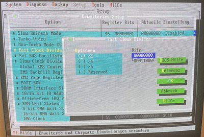

Reply 47 of 90, by mkarcher
Marco wrote on 2022-10-09, 17:00:

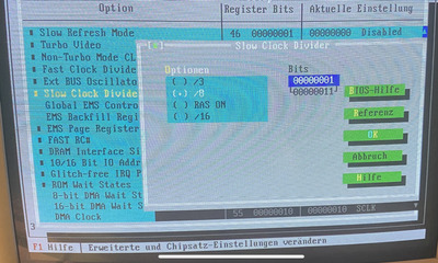

Me again with an update (or maybe updated question).
I found a working amisetup version - thanks to you - where I can set values we already bespoke.
As I just finished my w95 install plus network I don’t won’t to mess up my Bord fully.
Could you therefor maybe help me out with what exactly you would change here now?
PS: I can also directly change any registered manually
PS2: under option „ext bus osci control“ I can select fast or 10bit (default) only.
PS3: from what you/we figured out so far I would set fastclockdivider to /4 (and ensure a ground signal from the ext osci slot which I would take out)
What would you say? Thanks again
1) VLSI SCAMP 311 | 386SX25@TI486SXLC2-50@63 | 16MB | CL-GD5434 | CT2830| SCC-1 | MT32 | WDC160GB/7200/8MB | Fast-SCSI AHA 1542CF + BlueSCSI v2/15k U320
2) SIS486 | 486DX/2 66(@80) | 32MB | TGUI9440 | LAPC-I
Reply 52 of 90, by mkarcher
The options shown for "slow clock divider" make no sense. They should read "/2", "/4", "/6" and "/8" (so just like the "fast clock divider", but with "/8" instead of "reserved"). If you are able to adjust these settings using AMISETUP, you don't need to modify the BIOS code.
If you set "slow clock divider" and "fast clock divider" to the same value, you don't need to ground the output pin of the removed oscillator, as it doesn't matter whether the board chooses the slow or the fast divider.

Reply 53 of 90, by Marco
So I played around with both settings and I compared the bit settings with the manual table 16 (the one with green yellow red highlighted rows). If I select the values in amisetup that fit to these bits (00,01,10,11) it is not working anyway. System hangs at Boot/ won’t start at all etc.
Eg fastclock option /4 sets but 01. same as in the manual. Etc etc.
At least happy that I could restart the system with the ext osci then again. Puh.
The selectable values per option I cannot change.
Ps: at least I could enable slow refresh which „boosted“ my NU SI index from 19,1 to 19,7
