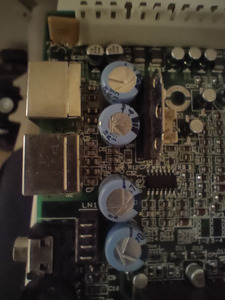

rasz_pl wrote on 2024-01-08, 15:53:
those capacitors look fine, no leakage, no corrosion looking closer at https://www.vogons.org/thumbs/52335_70daf02d3ca304935556 […]
looking closer at
all this black woven stuff is laminate material burned into pure conductive carbon, but you measured resistance and reported 16Kohm so it might still somehow be fine
>Tried this today, but same result. Kb works, but reports error and stucks if any of the keys with LED is pressed.
>So connector is off the board and soldered just 4 wires.
did you solder those 4 wires to original pads or like I suggested power/ground from molex/motherboard power connector?
LED screwing with communication suggests keyboard is powered by parasitic power only - either power or ground is not connected
take a needle, plug it into pin 3 of the ps2 connector (ground), measure resistance between needle and ground on the motherboard
>DCC vs Data pin: ~ 16kOhm
>DCC vs. clock pin: no connection, multimeter show 1
VCC 😀 and Clock pin should show same resistance to VCC as Data pin. Some keyboards will work without one, some will not.
WELL, you were right. I tested solution where power + ground was taken from the original source. With those connected to PSU directly KB works without problems and no error on boot!
Thank you enormous much! 😀
So how should I proceed from here? Should I take power/ground for kb & mouse from power supply or somewhere else? From PSU it takes direct power, is that good idea?
Why original source is dropping voltage?
Reply 41 of 88, by rasz_pl
check original PS2 connector VCC/ground pads, or whats left of them, for resistance to AT power connector 5V/ground. I suspect you burned out copper from one of those holes.

Reply 43 of 88, by rasz_pl
just for sanity check resistance of yellow element in this photo in upper left corner, I think Its marked FB1, afaik its a polyfuse - those normally do not permanently blow, but maybe yours did or you somehow damaged it mechanically while struggling with connectors
Reply 44 of 88, by boby
rasz_pl wrote on 2024-01-09, 05:52:
just for sanity check resistance of yellow element in this photo in upper left corner, I think Its marked FB1, afaik its a polyf […]
It is marked as F1 so I assume it is a fuse. Checked it before and it beeps, so should not be blown. Will check resistance as well.
Regarding my question from before. If I need to take 5V power or ground for my kb, where should I take it from? Directly from PSU?
Reply 45 of 88, by rasz_pl
Safest would be locating original break, easiest straight from under AT supply connector.
Reply 46 of 88, by boby
rasz_pl wrote on 2024-01-09, 13:19:
Is it safe to go from under AT connector? Should I add some fuse, or something?
Reply 47 of 88, by rasz_pl
You already have a polyfuse in the corner 😀 so pull 5V from there.
Reply 48 of 88, by weedeewee
boby,
Just an FYI.
https://theretroweb.com/motherboard/image/pl5 … c5166238295.jpg

But I Think I found the issue. On the image bellow there is a probe pointing to this component FB1, which I have no clue what it is, but the power trace from the kb, leads to it. However, when powered on and kb connected to original pins, this component shows 5V on the side where the probe is and 2.5V on the other side. So here is where voltage drops. What is this component and how to get a new one?

Reply 53 of 88, by DerBaum
FB is short for Ferrite Bead... wich is in fact like said from weedeewee really just a small coil wich should measure the same on both ends.

Reply 55 of 88, by DerBaum
boby wrote on 2024-01-09, 22:00:
So what should I do?
Find out if something on the side with the lower voltage is dragging down the voltage sent over the bead.
That is done by checking if something is connected between the lower voltage side and ground.
if you are sure the side with the lower voltage of the bead is really connected to "nothing" and the voltage still drops... its probably broken...

Reply 56 of 88, by weedeewee
do a resistance measurement on that component. and replace the component if the resistance is higher than 1 ohm.

Reply 58 of 88, by weedeewee
DerBaum wrote on 2024-01-09, 22:12:
weedeewee wrote on 2024-01-09, 22:09:
i suggested the voltage drop test because ferite beads can have a resistance from up to 2k ohm... this is why i linked the article on beads above.
I didnt know that too before.
The ferrite bead is in the voltage path that supplies power to the keyboard & mouse. the keyboard & mouse, according to google, should not draw more than 275mA.
Given that both like their voltage to be +5v +-%5%, the resistance of that component can be no more than 0.9ohm.
edit: it could be 1.8ohm if you go from 5.25 to 4.75, dropping .5 over the component, but meh.
