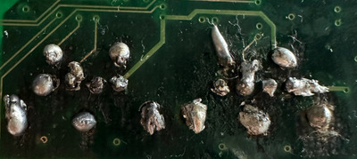

I got this PC Compaq Presario 7170, which had a problem with mouse port. It didn't work. Serial mouse is working.
I replaced both ports and soldered a new ones, but since then my keyboard is also reporting a problem on boot - Keyboard error. But it works. If I press any of the keys with led light (num pad, caps lock or scroll lock) keyboard stops responding. I need to unplug it and plug it back in to make it work again.
Even tough my soldering is terrible, I checked all the leads and everything is connected. I also checked surrounding caps and resistors and they seams fine. At least, what I know to check.
Any idea where I could go next?

That soldering indeed looks .. not great. Use flux to fix it, its possible you have more things connected than needed 😀

Yes, I know, it is far from great, but some of the points needed to be long as I torn some traces. Will fix those.
Still, I have checked each point several times, nothing is shorted or connected where it should not be.
It is strange that keyboard works but it reports problem. This is what I don't understand. Maybe voltage problem? In case I burned some components on the other side.

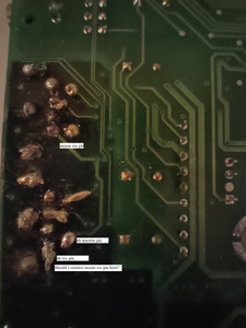

So only what is left is that there is indeed short somewhere, which I can't find. Also I noticed that it might be that I wired mouse voltage pin with inactive pin on kb. I cut that connection but result is the same.
Can it be that mouse is getting power from kb? Problem is that I torn wire traces, so not sure now what goes where.

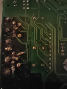

I did some resoldering (had to build 2 traces) and even everything is fine, still no luck.
What I found this time to be very strange is that I have 0.9V on ground pin. I know that this is wrong but don't know how to fix it, when there are no any obviois shorts.

Doesnt look all that better 🙁
Buy flux, watch few soldering tutorial videos, get something modernish from recycle bin with multilayer PCB and practice on that until your soldering doesnt look like in those pictures 😀
as for this board - desolder PS2 connector, clean everything around, just for testing solder wires between pins of connector and pcb pads without fitting connector back to the board, that way should be easier - only two pins close to each other, you can get power/ground from molex or motherboard power connector

I have a flux, I just don't have much soldering skills. I know it looks ugly, but I just wanted to see if it will work or not, then I would take it to professional to solder properly. Don't want to pay if it will not work in the end. Some of the pins needed to be soldered as they are, as there were missing trace wires. Didn't quite get, what needs to be tested without fitting connector? Could you please explain again?

I'd advise against soldering anything at this point. the board looks burnt.
Some of the damage was already there when I got it - someone maybe tried to fix it already.
But regardless, it is not working, so I can't loose anything if I try. If you can tell from the image that the board is burned, then I can give up, but is that the idea of the forum? This is not super huge important, it's a hobby. My idea is to share thoughts with people or get some good advice (like one before about soldering skills), but not just to give up on everything.

Yes, all the photos are taken with the zoom. It was like this from the beginning
