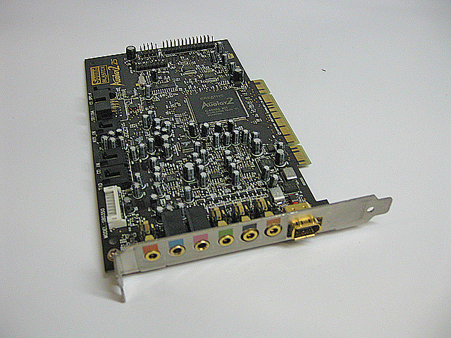

Another Audigy...
The attachment $_57 (1).JPG is no longer available

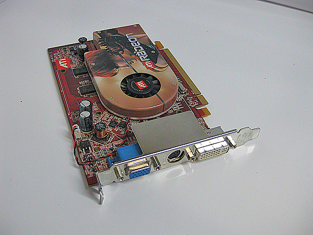

ATI X1300 PCI-e video card...
The attachment $_57 (5).JPG is no longer available

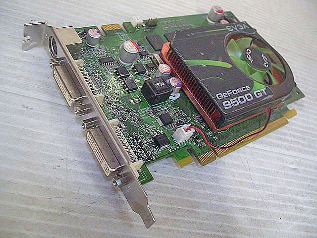

GeForce 9500GT...
The attachment $_57 (6).JPG is no longer available

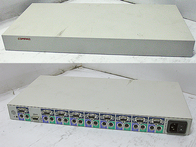

Another Extron Crosspoint switcher...this one has no audio switching capability, but I had to get it...for only $9, can't go wrong...
The attachment $_57 (7).JPG is no longer available

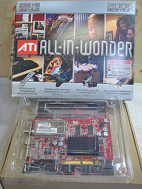

An ATI all in wonder 9600 PRO (this is my second boxed one I own now). I used this card in my main rig setup (s478 Gigabyte 8KNXP and ASUS P4C800) for over 7 years before moving on to a Core 2 Duo just 3 years ago and it never let me down. I do prefer NVidia for the most part, but I have a soft spot for this card...
The attachment $_57 (12).JPG is no longer available
yet another KVM switch...I'm going to have to quit buying these things...space is becoming a premium
The attachment $_57 (3).JPG is no longer available

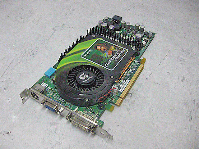

picked up this 6800GS PCI-e, just because I already had one and wanted to maybe try them out in an SLI setup one day, but they are kind of useless since I have much faster cards for my Core 2 Duo setup. Do these cards offer better compatibility with certain games? What's it good for since I can't use it for Win98?
The attachment $_57.JPG is no longer available

Hmm, looking at that KVM switch, makes me realize I need to get a nice switch for all my systems. Especially if I want to try to use the same monitor and keyboard for a lot of systems. 🤣
Reply 5816 of 59754, by retrofanatic
Yes, they come in very handy...it's nice to have everything connected, so you don't have to mess around with switching cables all the time.
I find a lot of the KVM switches I get now for a lot of time for less than $10 at a local recycler. They are very expensive new and for a while it was hard for me to find any at a reasonable price.
One of the reasons I have so many now is because I can get them for so cheap now, but also it's because I am always looking for one that does not degrade the quality of the image too much.
<snip picture>
The 6000 line of cards are fully compatible with Win98se, For the AGP versions.. but not the PCI-Express versions (no PCI-Express based systems ever released chipset drivers for Win98 that I'm aware of).
No fan? My little 9600 XT had a fan!
Reply 5819 of 59754, by ReeseRiverson
I have the same All In Wonder card he does, and there is no fan on mine either.
