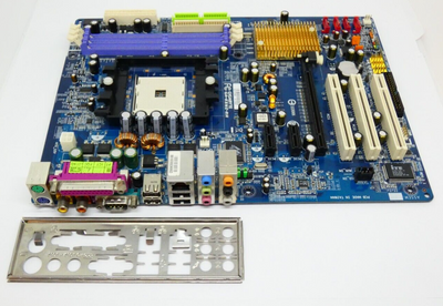

And yeah I was the one who bought that board but I also grabbed the Gigabyte GA-K8NE-RH that was also listed, the K8NE needs a recap but I'm not sure if or when Ill get to it, it may end up in the spares bin for a while as I have other boards that need recaps first.
I will say the GA-K8NE-RH is a very nice looking board essentially being a full refresh of the K8NE. Thankfully this board has caps that look ok and the board has been tested ...so fingers crossed !
The attachment Gigabyte GA-K8NE-RH.png is no longer available
And yeah Ill throw a fan on this one too since its also a Nforce board.
Oh, that sounds all too familiar to me now. 😁
I also have quite the line up of "spare" boards waiting for either a recap or other work.
I'll probably get them all done if I have another lifetime.
Actually have caught up on that list quite a bit. Just need to get to testing them all out now (properly, that is.)

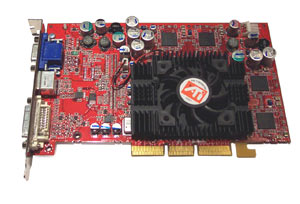

I think that's an SE. I have the same style of card in my Athlon XP system. It is branded as a Radeon 9800SE and has the same style of memory (rectangular chips, 128 bits) and core. However mine has a Radeon 9700 type HSF and a floppy power connector. I believe it scored 4200 pts in 3DMark03.
Radeon 9800 se has memory 290mhz and 3.3 ns memory chips bga or tsop . This card have 5ns chips... It is still 9800 se but cuted even worse.
Here is 9800 SE by saphire
Both of the 9800 SE cards that I've had looked like this (I know for sure one was a Sapphire, the other likely was as well). When I found the guides for how to unlock the extra pipelines with Omega drivers, they mentioned that the best 9800 SE cards were 256 bit, so very close to an actual 9800 Pro when unlocked. Curious to know if anyone here has ever had one of those and/or knows what to look for visually to tell the difference ?
Its quite simple ,9800 se 256bit based on 9700 pro pcb , however its possible unlock 4 extra pipelines at any 9800 se card its just luck based . It wont be 9800 pro but would be faster anyway. here you can read more
It looks like the biggest tell is the memory chips. And yes, I recognize that it's always the luck of the draw when you do this sort of thing, same with the extra cache on a K6-2+, extra cores on certain CPUs, etc. And a cooler upgrade is mandatory if you are going to run it unlocked, the stock cooler is barely adequate under normal. My 9800 SE for comparison.
