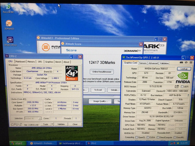

Reply 40 of 66, by zuldan
Installed a 7600GT in the machine to replace the fake 9800XT. Maxing out the 3700+. Not 100% period correct but much better score ;-P
853.15 KiB
483 views

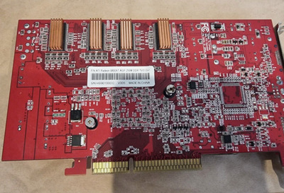

I'll play with the fake 9800XT and see if I can get the 9800SE firmware working on it.
Reply 41 of 66, by momaka
zuldan wrote on 2025-02-06, 07:40:
No point, you probably won't get anything further out of this in terms of performance, since the slow RAM is the limiting factor.
If anything, you might either brick the card or make it artifact if the 9800SE BIOS tries to run the RAM at higher clocks / lower timings that the installed RAM on this card doesn't support. In fact, the latter is very likely to be the result. Whatever the China factory that churned out these did to the BIOS probably was for a reason and can't be improved on. And again, I suspect that since the RAM is ran at 183 MHz instead of the full 200 MHz that the chips are rated for, then they are probably either reject or pulled chips with issues... so that RAM speed is as good as it will get.
Instead of flashing, try using ATI Tool to see where limits of the RAM and GPU are. If you can't increase anything, leave it all as-is.
65C02 wrote on 2025-02-06, 01:19:
That looks exactly like my card. I would have to double check the memory chips, but I'm pretty sure it's a Sapphire.
Nah,
Sapphire never used those shit cap brands.
The PCB may be a copy of Sapphire... but I'm pretty certain it's just a no-name Chinese factory that churned out this card and not a known AIB.
I'd say it's pretty much period correct.
Sure, when socket 754 came out the GeForce 7000 series were not out yet... and I don't even remember if the 6000 series were (but I think they were.)
Still, I'm sure that anyone who would have had such high-end s754 CPU at the time probably kept their system for a few years - enough to catch the release of the GF7000 series and still be considered a decent rig.
So at least in my eyes, it's period correct. 😉

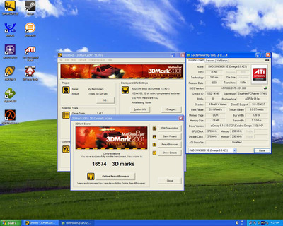

zuldan wrote on 2025-02-04, 11:03:
Ok here’s an update […]
Ok here’s an update
1. Disabled AGP Fast Write in the BIOS
2. Reinstalled XP
3. Installed VIA Hyperion Pro 5.24A drivers
4. Installed .NET 2.0
5. Installed Catalyst 7.11 drivers
6. Made sure V-sync was turned off
7. Set Catalyst option to Performance
Got a 3DMark03 score of 3600. A nice little improvement but still massive performance issue.
BUT…
I think I found the problem. If you look at the specs on my card
107.84 KiB
1458 views
The graphics clock should be 412Mhz and the memory clock should be 365Mhz https://www.gpuzoo.com/GPU-ATI/Radeon_9800_XT.html
Is it possible the previous owner flashed another BIOS? Or is it possible to set the graphics and memory clock speed in the BIOS?
I really hope the previous owner hasn’t down clocked the card to hide some issue. Arrrg!!
Judging by the GPU-Z screenshot you posted, your card is a 9800SE. A cut down 128bit memory bus version with lower GPU clock and slow memory. If that is indeed the case then your 3dmark score is perfectly fine, as that's what a 9800SE scores. It's weird that it's detected as an XT, but I've seen this before.
https://www.techpowerup.com/gpu-specs/radeon-9800-se.c108

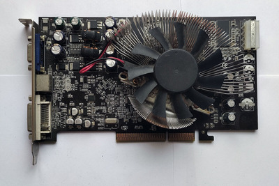

Trashbytes wrote on 2025-02-04, 23:22:
None of the 9800 cards show there even match the component layout we can see on this card, the sticker on the back suggests this […]
Grem Five wrote on 2025-02-04, 15:47:
zuldan wrote on 2025-02-04, 12:18:
Here are pictures of the actual card
242.84 KiB
1387 views
711.83 KiB
1387 views
What made me wonder is those memory chips none of my 9800s have that style of chips, pros or XTs.
Only place I have seen that style of memory chips is here: https://archive.techarp.com/showarticle0a06.h … artno=92&pgno=2
None of the 9800 cards show there even match the component layout we can see on this card, the sticker on the back suggests this is an ATI model but again it doesn't appear to follow any of the known ATI layouts for the 9800/Pro/XT. The two chokes/coils are a dead give away something isn't right here as I dont believe ATI ever used that type on their cards.
It could be a weird ATI model for all I know but too many other things are odd with it.

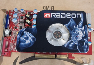

Could it be a modded 9800 SE ? This one from Palit uses a crazily similar board component layout along with similar ram and a 128 bit bus. This image is missing a few caps but you can see how the layout would be if they were present, the 9800SE used lower aulity parts, had similar clocks to this card but it used the R350 core.
357.76 KiB
879 views
Palit 9800 SE
Just noticed this post. Your card is definitely a 9800SE or some other cut-down version. You can tell by type of ram you have installed - 5ns PGA package (rectangular, long, visible pins). The 9800XT only comes with 3.2 or 3.6ns BGA ram (smaller and square)

you got one of the good ones with decent ram on it, Zuldans has exceptionally shit Nanya on it and its performance matches the ram.
Would make a half decent test bench card as itll be pretty much useless for anything else.
