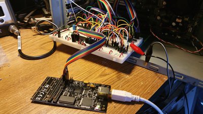

The shipment of parts got delayed until tomorrow, so I will have to wait until then to start building this thing on a breadboard for testing.
Reply 64 of 611, by ab0tj
Some parts are starting to show up. This project is starting to exist in the physical world now!
Reply 65 of 611, by ab0tj
The ISA prototyping board finally arrived last night. Shipped from Thailand, no wonder it took so long. I soldered some pin headers to the ISA signal area and wired it up to my breadboard. After correcting the order of the address lines, I can at least cause a MIDI program to lock up. Previously it was just "could not initialize sound hardware". I think something is wrong with either my code or my wiring as the status bits are not being reset. More debugging tonight as time allows. But at least it's progress!

Success! After some software debugging, I now have a working UART implementation on a breadboard. Now to start porting the intelligent part.

More success after some coding today. I now have intelligent mode working! It was pretty much just a dirty hack job of porting SoftMPU, but I have successfully tested with Silpheed. I still need to investigate some stuck notes and glitching, though. The firmware definitely isn't done yet. More debugging tomorrow as time allows.
You can check out the current code here: https://github.com/ab0tj/HardMPU/
