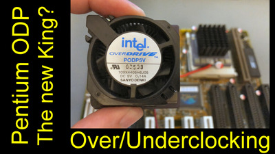

Ok here is my attempt on this:
https://youtu.be/JVpmTlndEco
A lot of information in this video. I think I cover everything.
Half of the video is about modifying the cooling and the voltage regulator.
The rest is Overclocking / Underclocking records.
