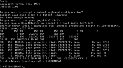

ok Matrox Impression games do not run on other Matrox video cards for sure.
i am managed to remove hardware check of Sento game and it crashes on any video card, even om Matrox Millenium.
So low level emulation LLE needed to run those games/ software written for Matrox Impression.
Currently 86box can emulate Matrox Millennium / Millennium II/Mystique / Mystique 220. The Matrox Impression probably can be a different chip with different 3d capabilities than those already emulated later Matrox cards.
Or maybe i am not careful enough on removing hardware check.
