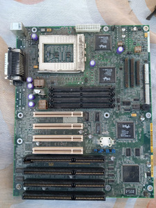

In other turn of events I finally scored THIS baby. It took me many years but finally I got one! My very first Intel Venus VS440FX. Shocking Blue - Venus A little banged up but I'm not complaining. 😁

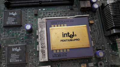

I'll pair it with my PPRO 180MHz I found a while back. Add to this some high capacity EDO SIMMs I also found a while back and I'm golden. 😀
Socket 8 in the house ready for action at a moment's notice IF the mobo or the CPU are still alive! So many unknown factors! The CPU has a damaged pin that I managed to fix but other than that everything is possible.

A few years ago I got one of those boards (at least I believe it's the same model) in a banged up case for 10€. I didn't know what I was buying, only saw the typical connectors of an AWE64 Gold on the back of the case so I got it. Sadly the HDD case had come loose in the case and the motherboard had deep scratches with several cut traces. AWE64 and CPU were in great condition though so good investment nonetheless. 😄
I still have the motherboard in my scrap pile I believe.

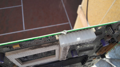

There are quite a few problems with this baby but I think that none of it is terminal. 😀 Some green stuff near the battery holder, and ISA slot that needs plastic surgery, a cracked PCB on top of the ATX power connector where I need to repair a torn trace(good think that there is nothing too important there), a SIMM slot with a twisted plastic part, a few bent pins on a chip, some bent pins and a few bits of plastic missing on the parallel port, but otherwise nothing missing. It's fine! Minty fresh! I'm sure that all of it will buff out. 😁
This motherboard had a tough working life and an even rougher retirement. Good thing that I got to it. The seller said many times that he had it but I lost hope of getting it as he kept forgetting about it. I was sure that it was minced meat as he deals with scrap and sells quite a bit of this stuff.

I think Gateway used that particular board back then, but I digress.

This summer I saw a Gateway 2000 PC on a local add site but I simply didn't have the $$$, so I lost it. It had the same motherboard inside.

Today, over the course of a couple of hours I managed to address all of the cosmetic issues of the VS440FX motherboard. All that remains is to repair the torn trace and give it a deep clean.
I'm quite anxious to power it up but I have to be patient. The 180 PPRO with the glued pin entered the socket like a glove. I rescued it last year, lots of pins had to be straightened.

The Socket 8 motherboard is giving me the fits, as a lady she is ... As this threw a spanner in my works I have to change plans and prepare another episode.
