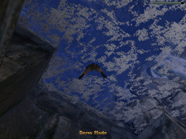

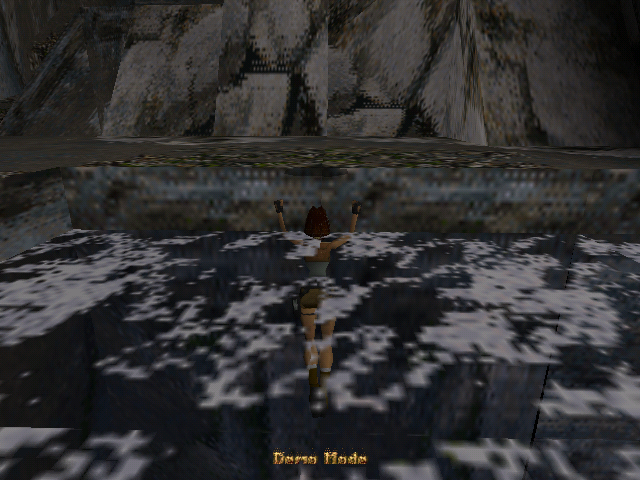

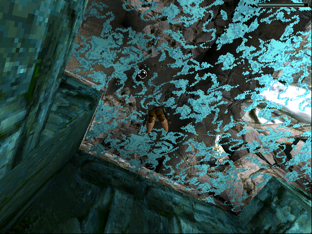

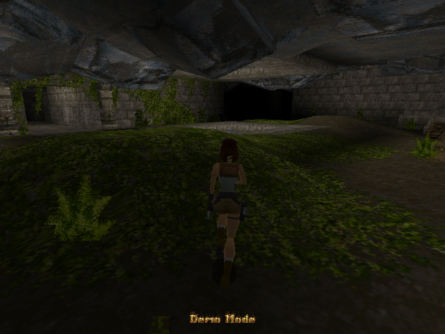

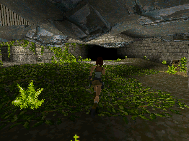

PowerVR:
Rendition:
There's still a lot of stuff that doesn't work in the Verite emulation, like alpha textures, fog and bilinear filtering. It's hard to get good info, plus RReady is closed source and I don't think anyone fully reverse engineered it yet.

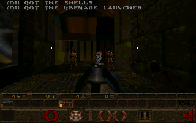

@The Solutor: I got vQuake to work but it looks off..
Reply 88 of 159, by The Solutor
Dividebysandwich wrote on 2026-10-07, 18:31:
Ok, good, but really I linked RR just because happened that I looked at the related thread yesterday, and the matter was somewhat related to the PowerVR wish.
