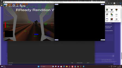

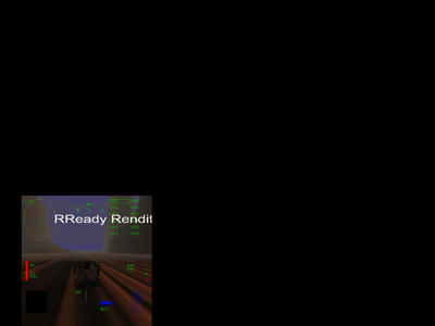

Reply 3 of 3486, by BEEN_Nath_58
I tested with SODA Off-Road Racing and it works quite well. I have this question: how to keep the resolution unforced?
Oh and didn't MechWarrior 2 Titanium support RRedline? I will check out tomorrow, but you'll know better.
Edit: It does, but I am not getting it to work properly (check attachment).
Edit-2: Look at the textures too (stretched?). Until I hit Exit, it appears like this.
Reply 4 of 3486, by sharangad
MechWarrior 2 Titanium is rredline. I forgot to add it to the list . I can't get it to run at all on my Dev system (win 11 amd, nvidia) . How'd you get it going?
Can you attach your log files after running mechwarrior? Just hit zip log files. It should open an explorer view with the zip file highlighted.
To keep the resolution unforced, in rendition.cfg set the remapall=max to remapall= <blank>. (at the very end of the file). Alternatively remapall=640x480x60, if the refresh rate is too high.
Alternatively, you can put a # sign at the start of the line to comment it out.
You can also comment out remap all and add
Remap640x480=640x480x75 (for 640x480@75 Hz). Games that need Win 98 compatibility can't use =max because resolutions higher than 1280x1024 are hidden as well as the refresh rates.
Forcefullscreen needs to commented out as well, only quake 2 needs that.
A lot of rredline games use an 85 Hz refresh rate which for a lot of 60 hz panels isn't doable. So remapping 640x480 and 800x600 is a good idea.
I should probably add a native option to the resolution selector.

Reply 5 of 3486, by BEEN_Nath_58
sharangad wrote on 2023-08-13, 03:22:
A comprehensive guide to install and play MechWarrior 2 on new versions on Windows.
Check the MechWarrior 2 Titanium part.
This brings the game properly to fulllscreen, the texture bug is there, I will add log.
I think it is better that RReady decides to choose the monitor refresh rate by as default, instead of looking for 85hz. The 85hz option can be set as "unforced" - refresh rate; in the resolution selector applet.

Problem-2:
MechWarrior 2, if you run it in DxWnd windowed mode as I specified earlier, would flash in Rendition mode. This also happens in fullscreen mode, if I run the game in Glide, then in Direct3D, and then switch to RRedline without exiting the game. It could be a DxWnd problem as well, but you can inspect it better.
Problem-3:
I enabled MSI Afterburner to monitor the status. There looks like a memory leak, that hogs the FPS gradually.

Could you add CopyBack=1 to rendition.cfg to see if it helps.
Edited: That fixed the flashing, but the game crashes on 2nd run! The texture problem, and the fps decreasing still remains.
Log for the crash

The flashing problem seems related to CopyBack surface, it seems. MSI Afterburner reports main game value, while DxWnd reports copyback surface value.
I don't know how many things are refreshed by the game, I can see 7 different FPS values for the game on screen when CopyBack=1 and OpenGL is DxWnd-hooked:(
CopyBack renders to another OpenGL window and blits the data using GDI calls onto the main window. I recently added this because some games use DirectDraw for menus, which is incompatible with OpenGL.
[EDIT]
Fixed not being able to start another level.
The world texture issue is clamping. For some reason the floor texture is clamping to its original size.

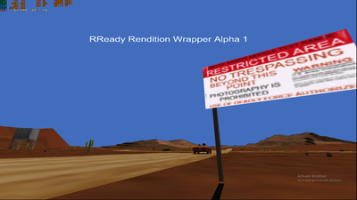

Interstate 76 looks beautiful. It has problems. The game crashes with an error that reverts to SW renderer.
This scene is at a higher resolution. The .cfg said 640x480 but the screen is not. After logging out and in, I changed to 800x600 and back to 640x480. Now the game in fullscreen goes out of window and is slanted. It is as if the game doesn't want to follow the file.
Reply 15 of 3486, by sharangad
BEEN_Nath_58 wrote on 2023-08-13, 08:28:
If you could post a handy link to a guide to getting it to run. I'll look at it as soon as I fix mech2.
