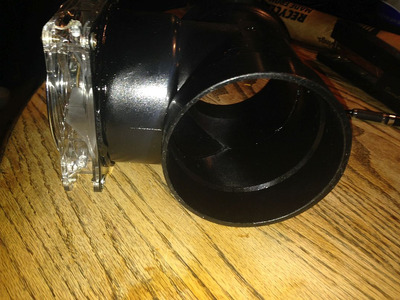

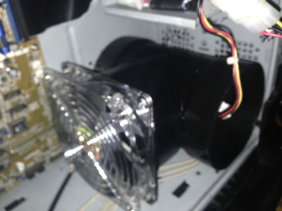

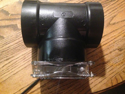

Long awaited Vento 3600 Case mod. Pics Apologize for the blurry images, I think that you will get the idea though. This will suck cooler outside air from the front scoops and blow it into the PCI and AGP area. Allowing my Graphics card and voodoos to breath some.
Since the entire case is basically sealed with no other air intakes. The back pressure from the rear 120MM fan and the PSU Fan will further help pull more air through this contraption than the 30a front fan can alone.

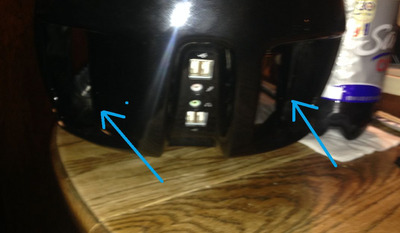

thanks, the case looks artistic to the right person, but that comes with some serious flaws. You can tell they were onto something with the bottom 2 air intakes, but it was never executed. I don't know if it was cost or complexity but it was never working right with one 40mm fan blowing horizontally from the factory. the potential is there for a solution such as mine maybe it could of been better if it didn't seem like it was there for looks and the cooling didn't seem like and after thought.

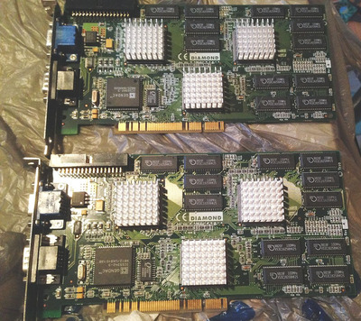

Heatsinks arrived. probably not perfectly centered but not the worst. I'm sure they'll work just fine.
Looks better than mine 😁. The silver aluminum looks nice.
Reply 87 of 97, by Warlord
3M thermal tape. Ya you could remove them, I didn't use glue. I'm not sure what the cure time is though. I was thinking of sitting them outside in the sun 1 afternoon just to make sure it gelled properly before installing them. They recommend twisting them back and forth a little while applying pressure for ridgy, I didn't want to do that too much.

Some progress. I have another fan controller this time and it works properly. I might get some thermistors for it since it supports 4 of them. But I don't need them. I got the custom fan I made installed and the heatsinks on the voodoos. Surprisingly they don't even get warm. Also I don't experience any of the problems other people have with running voodoo2 on fast cpu. Them getting hot and bugging out and what not. This Thing goes balls to the wall and its more stable than any of my other rigs it seems like.
