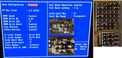

So, ran couple of DOS interactive graphics tests for the two ARK1000VL cards.
No difference in Quake1. Tiny difference in Doom - 1222 vs 1223 realticks. Tiny difference in Wolf3D - 0.1 fps.
Basically a rounding error.
If you setup jumpers and BIOS as shown below, you should be able to hit 25.8 FPS in vanilla Phil's Quake1 with the POD100, without any "cheats".
Verified it locally with the 2TheMax ARK1000 card.
182.27 KiB
1125 views
While this delivers best graphics perf - no audio for you, as PC-Engineer mentioned in the previous post.

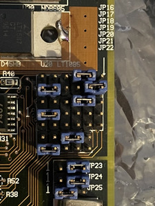

My jumpers are set a bit different for POD 100 L1 WB. I used all blue jumpers for contrast, except the last one on JP29 which is jumping 1-2, ran out of blue. My Bios settings are same as yours, make sure both L1 and L2 are set to WB.
I’ve also got 0ws and no delay jumpers set, as shown below.
Let me know!

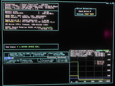

Any idea which specific BIOS/jumper settings made the difference between 59.95 CPU score in speedsys (which I also now get with the 4DMS HL3G VI) and 61.53?
Are you sure that L1 WB is fully working? Can you format a floppy from DOS mode with no errors?

I tried briefly tonight to record a video showing 18.8 fps in quake1 on 5x86 cpu, but the rig kept producing 18.4 instead. Also, all tests shown lower scores than what is listed in the fat chart you linked above. I am probably missing some detail. Will try more carefully tomorrow.
With pod100 and L1 cache in WB mode the system gets quite unstable here. Can you comment on overall stability you get ?
Also, is that with 1m L2 cache ?

18.4 is still better than I’m getting, keep trying! Or let me know the jumper combo that produced those results to see if I can match it.
I’ve not done any stability tests with the POD100 in this board, other than a bit of dos gaming, anything specific I should try?
Yes correct, 1MB 15ns cache.

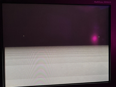

So the Second Reality demo crashes quite often on the dancing dot section with L1 jumpers configured for WT or WB with POD installed. I think I remember reading some issues with this demo and the ARK? Or is it possibly something else? I’ve not tried it with the 5x86 yet.
Update: crashes on the same spot with the Trio32
Update 2: same crash on 5x86 WT w Trio32 wtf
Was hoping to use this for stability testing 🤣.
Reply 93 of 266, by PC-Engineer
Its a known bug. The path of your directory is too long. Try to move the demo near your root directory and/or shorten your PATH line in your autoexec.bat.

Thank you good sir, two loops in on POD100 WB/WB!
