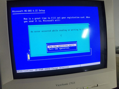

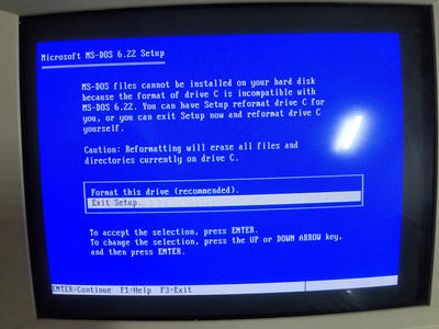

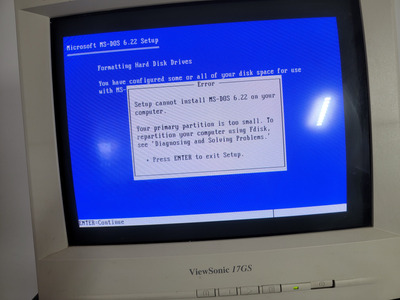

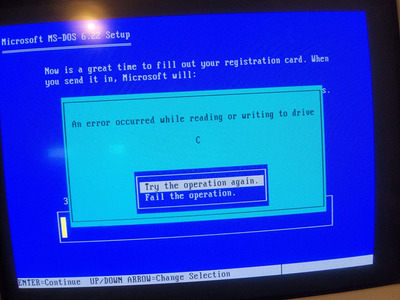

Problem: I formatted the SD card into FAT16 partitions of 2 gig each. Bios was able to auto detect my hard disk as 1690mb. I am able to boot to the A Drive and start MSDOS installation. MSDOS says it needs to format the unallocated space for the installation. I only have the option to proceed, in which I do. After it gets to 100%, it gives me an error message saying that "The Format of drive C is incompatible with MSDOS 6.22" OR I get the message "An error was detected while formatting your primary hard disk partition. I get the same error message with Win95. I have tried formatting to different hard drive sizes that are preset in Bios (and making sure Bios is set correctly), but I either get the same message, or that my hard disk is too small. ONCE I got past these messages to 3% installation of MSDOS, then got "An error occurred while reading or writing to drive C."

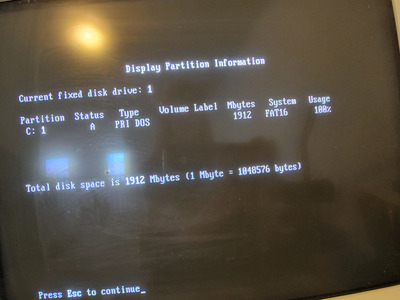

Boot the MS-DOS 6.22 installation floppy then exit Setup (F3). Run fdisk. Select option 4. Does what is on the scren meet with what you expected?

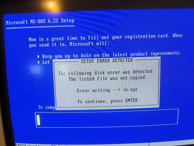

I ran FDISK. It says my partition has 1912MB, FAT16, and it's primary DOS. Not sure what Status A means, or Usage at 100%. However, upon exiting FDISK, I was able to get past the disk errors and get to 3% MSDOS installation (again) and it gave me a read/write error. (See attached pics.) I got to this once before and the same thing happened with another formatted SD Card.

Stop using other machines to partition and format the cards.
You need to do it all on the target machine - use auto-detect in the BIOS, boot with a floppy and use fdisk to remove whatever partitions are there and create a new one. Then format it with the /S option to make it bootable.
