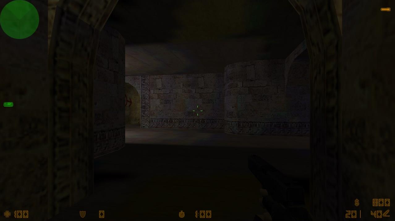

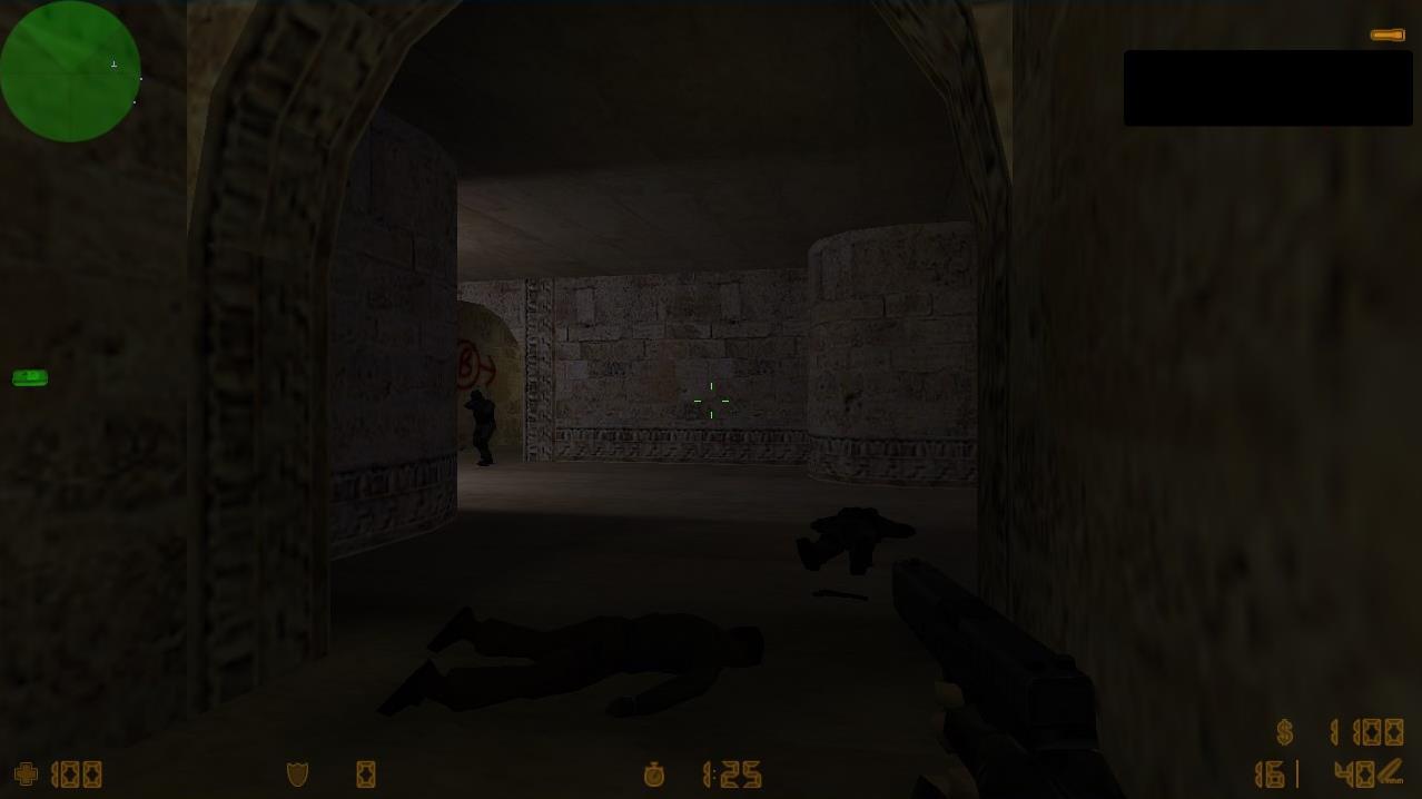

I wanted to play GoldSrc games in D3D due to overbright working out of the box and better performance, but D3D produces these ugly rainbow pixels on the textures. I believe it might be related to the lightmaps but idk. I tried WON 1.0.1.6, 1.1.1.0, 2005 Anthology and others but they all have the exact same issue (regardless of game/mod). Is this a bug or is it just how D3D works? OGL doesn't do this but overbright doesn't work on OGL by default.
Specs:
Windows 10 64bit
16GB RAM dual channel
AMD Ryzen 3200g
AMD Vega 8
Dust 2 is one of the nastier examples, so I chose it for reference.
D3D
OGL

Which game/build is this?
The rainbow looks like failed dithering in 16bit colours
Reply 2 of 4, by leileilol
natural phenomenon of the RGB565 texture format as the green bit is a larger range. There's no option to change this for D3D afaik, doesn't have to do with overbright or screen color depth

leileilol wrote on 2024-05-27, 05:10:
So it's meant to look this way? That sucks. I guess I'll have to figure out overbright in OGL then. Thanks for the reply.
Reply 4 of 4, by leileilol
It probably looks better in GL as the overbright luxels get shifted out so the color range is better for 565
