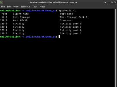

Type aplaymidi -l while MUNT is loaded to see which port it is using. For me it is 128:0. Enter this information if Dosbox or other programs that look for the MIDI port for MT-32.

You can run MUNT and TiMidity++ at the same time. They will open their own ports as shown in my screenshot below. I load MUNT first then TiMidity, during startup, and I delay the TiMidity autostart by a few seconds, to prevent port mix-up in games.
So for a profile that uses SC-55, I use the port 129:0 (taken from the aplaymidi -l output) in Dosbox or 86Box.
I run them both at startup via autostart, so that both MUNT and TiMidity++ run in background, and there is no need to keep a terminal window open and running.

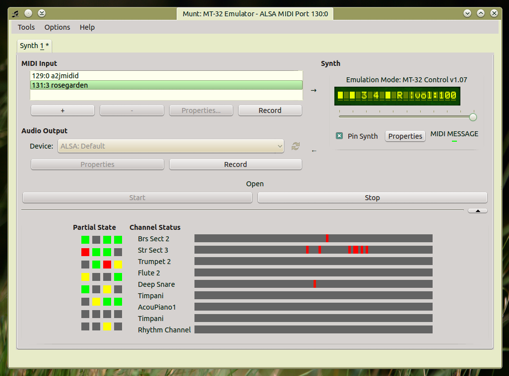

THe 2nd record button on the Munt Qt interface at the 'Audio Output' part is for recording audio/wav:
http://linuxmao.org/dl6602?display
