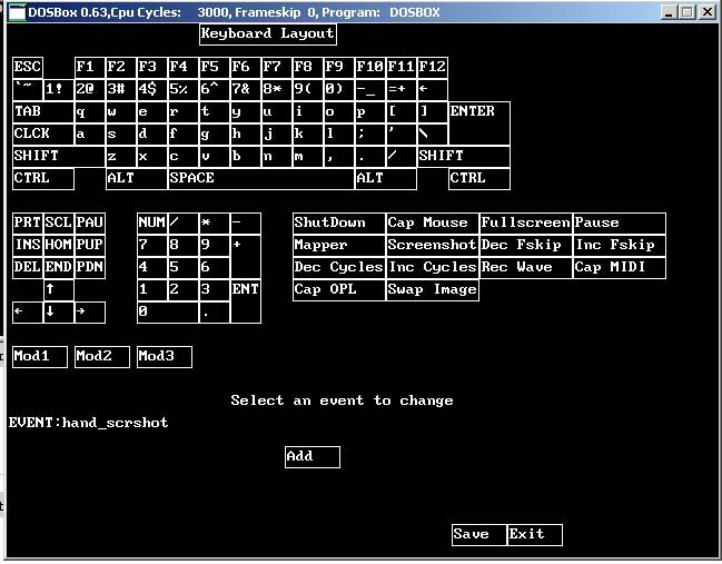

Everything works well, expect that I can't use the ALT + F5 command for pasting something copied off a block. -> Dosbox always takes a screenshot when I press that combination.
Thats strange, in the readme its said that CTRL + F5 (and not ALT + F5) is set for screenshot by default.
I also tried to change it in the mapper, but the changings, though saved and readable [ http://img.photobucket.com/albums/v93/Shinobi … /screenshot.jpg ] don't take any effect. 😖

re-assigning should work. there is no reason why it wouldn't work.

Heureka!
It wasn't a Dosbox-specific issue, I just assumed that because it only occured when I use fasttracker2 dosbox.
I reality its been a setting from my ati graphic-cards-driver. 😅
I found the solution here:www.ghisler.ch/wikide/index.php/Alt-F5_ ... cht_(mehr) (in german).
Modifying the regedit finally unbound the creepy key-combination. 😀
@Targaff:
just exchange the text in ...\DOSBox-0.63\mapper.txt with this:
