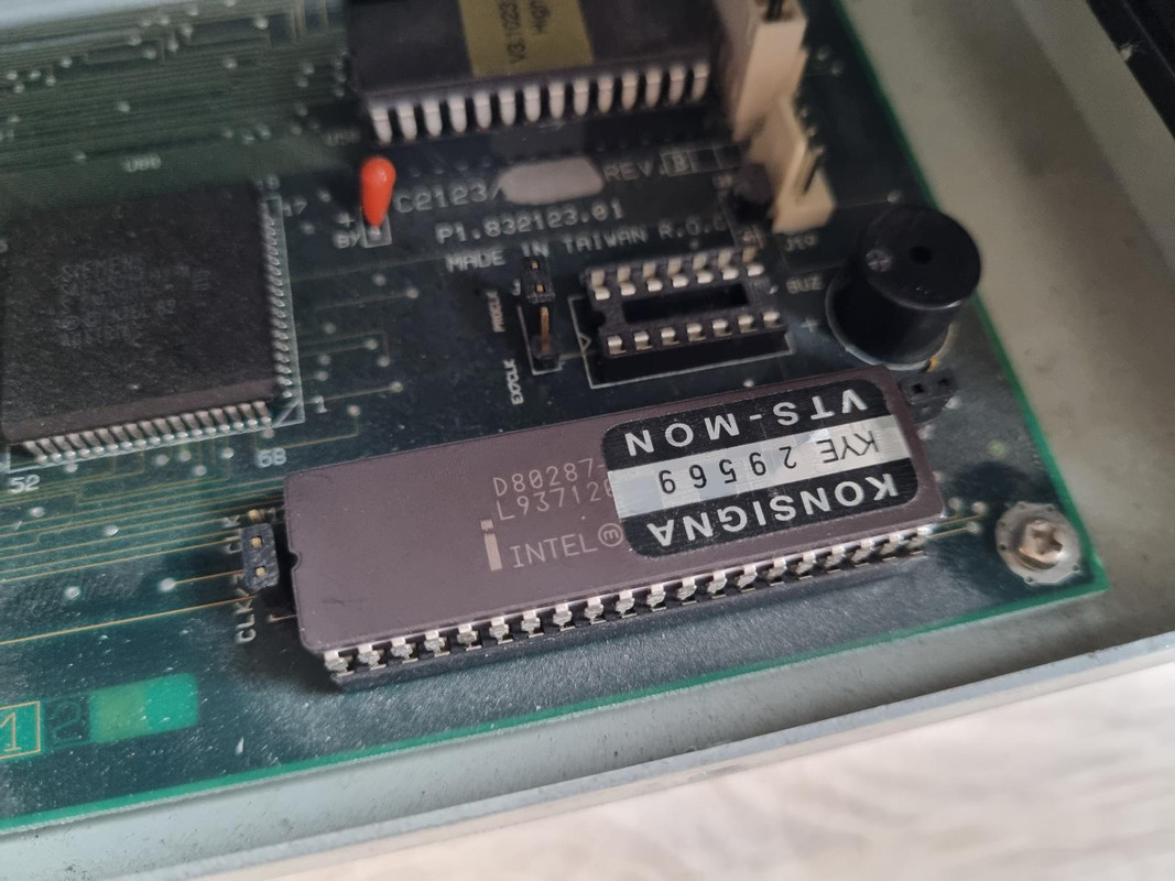

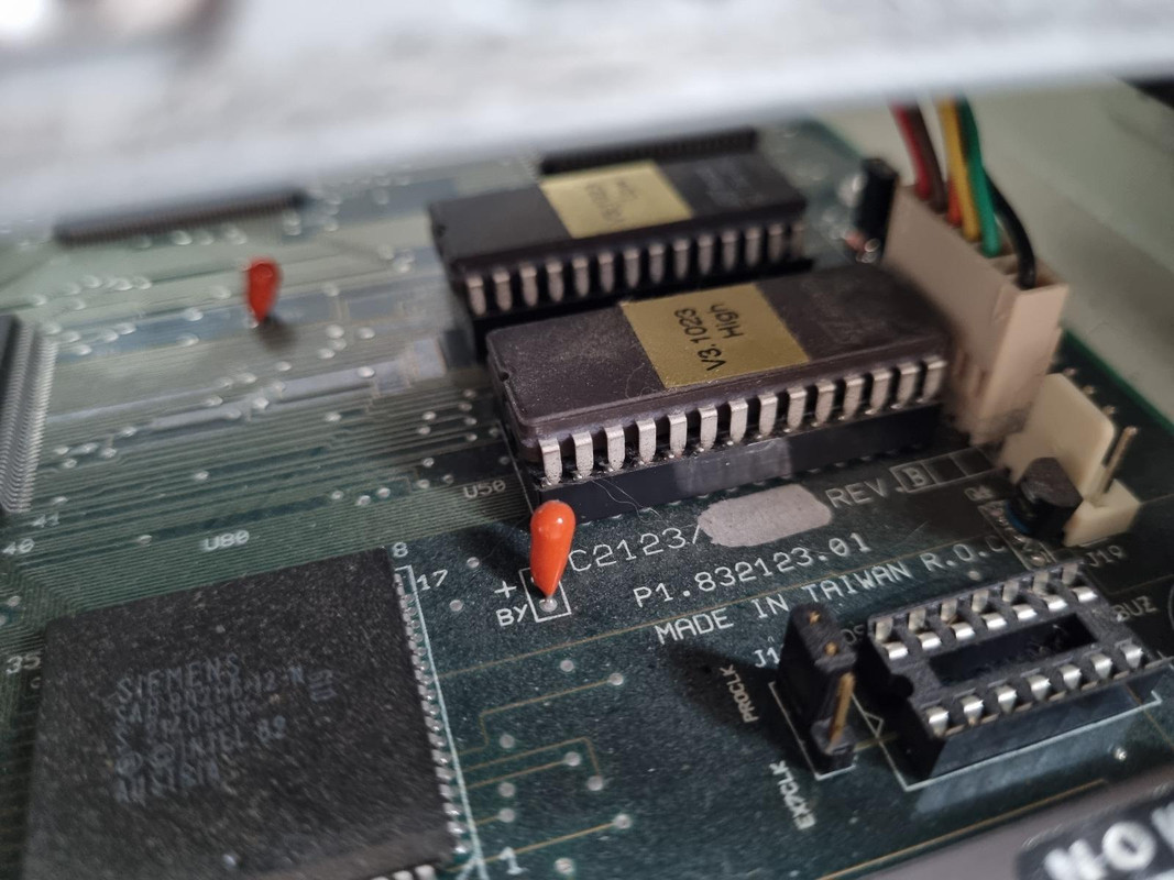

I managed to get my hands on this beautiful 286 PC and wanted to ask few questions here hoping the gurus can help.
1. Anyone seen this motherboard before? what model is it ? Trying to find any documentation.
2. It has onboard VGA and EGA video card, I assume there should be a way to select which one is enabled? there are two monitor outputs at the back labelled VGA and EGA. Is it possible to disable the onboard VGA card and use a separate ISA card? I got myself a Realtek TVGA 9000 ISA card which I would like to use.
3. the previous owner removed the 3.6v barrel battery and soldered on a button one - is it sufficient despite being only 3V ?
adding pics that will hopefully help identify the motherboard. Click on image to see full size.
thank you in advance !

Reply 2 of 13, by Omarkoman
thanks, will give it a try. The onboard video only has 256kb so lets see what happens.
next question, the CPU is Siemens SAB80286-12-N and its not socketed but soldered onto the motherboard, see these two photos :
https://i.postimg.cc/65Hq2kBq/retro-pc-pc286m … 199090550-1.jpg
https://i.postimg.cc/jSL5zMjX/retro-pc-pc286m … 199090553-1.jpg
how can I find out if I can upgrade the CPU to higher ? eg the Siemens SAB80286-16-N CPU 16-bit 286 Processor 16MHz
https://www.ebay.com.au/itm/392633246436
they are very cheap and I wouldnt mind extra speed.
I also found these 25Mhz ones from Harris:
https://www.ebay.com.au/itm/392380447376
what other parts would I need to upgrade ? would I need to upgrade the FPU / coprocessor as well ?
Reply 3 of 13, by jakethompson1
A 286 is not positioned to take advantage of any SVGA features, so you may as well stick with the onboard VGA.
As long as it holds settings and keeps the time (as opposed to freezing in place) when powered off overnight, the battery is good enough.
To go from 12 MHz to 16 MHz, the entire chipset has to be able to handle 16 MHz. It may or may not be ready to do so. A lot of those old chipsets are stamped as 16 MHz, 20 MHz, or 25 MHz if they are so capable.
Reply 4 of 13, by Omarkoman
Re vga, i get it and i dont want svga just best image quality and speed for dos games, would have thought fast isa vga card would help.
As for the cpu upgrade, what other parts of the motherboard would need to support faster cpu?

Clock speed on older systems is typically tied to the crystal oscillator. Overclocking a 286 would involve removing and replacing the crystal.
As was mentioned, this will effect other components besides the CPU likely including memory chips and possibly the ISA bus as well.
Unless you know exactly what you're doing, I wouldn't recommend trying to overclock a 286. If you want a faster 286, the better option would be finding a board designed for faster speeds.
