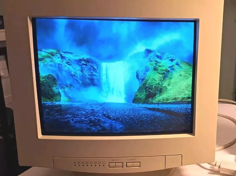

Does anyone know anything about this monitor? Seems a bit of a mystery online and I'm trying to 1, troubleshoot an issue and 2, find out more info on it.
I'm curious to know its output resolutions and refresh rates as currently it seems to have a really random assortment of both in Windows which seems to make no sense (lower refresh rates at lower resolutions?)
Currently it has:
1024x768 @ 60hz (my poor eyes!!!)
800x600 @ 85hz
640x480 @ 75hz (??)
Thats with the plug and play Windows driver though so i suspect this is off. Anyone know more about this? Perhaps a driver etc? ๐Ÿ˜
As for the issue, it will randomly turn off as if it has a power saving feature or if its put to sleep (it doesn't and its on a MS DOS PC) it did go through the mail and it has a noise coming from inside like something is loose so I guess its likely damaged but just curious if anyone had any other ideas? It flashes an orange light fast when it goes off.

The monitor turns off and a orange light flashes rapidly. Pressing keys does not turn it back on only a hard power off and back on with sometimes bring it back to life.

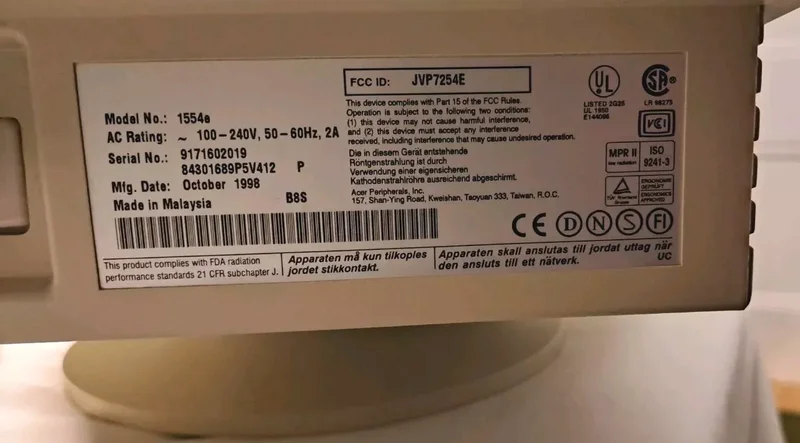

Crinale0 wrote on 2024-08-20, 17:31:
It is indeed...
a FCC ID of JVP* means Benq, which confirms the tiny print as at the time Benq was a division of Acer ๐Ÿ˜€
Could it be this one? https://elektrotanya.com/acer_7254e_crt_monit โ€ฆ f/download.html
If it is... TDA4866 vertical amplifier says 50 to 160 Hz, as for horizontal there's a TDA4858 sync processor... "Simple frequency preset of fmin and fmax by external
resistors"... later on it explains the math to do to calculate them, and going through it backwards:

So it's an XGA class monitor that, according to this piece I wrote for a completely unrelated design https://consolemods.org/wiki/CRT:CMC-531x - can at best probably pushed to 1024x768@70 ๐Ÿ˜€
There is such a thing as "Nutek" power saving, a "backwards compatible" alternative to DPMS, based on looking for a black enough picture for a sufficient time ๐Ÿ˜€
But indeed I would much rather be suspecting poor soldering in the power supply and horizontal (ie heavy & hot & high current parts) - an easy fix IF the designers didn't think it would be clever to use so much shielding that you need 20+ minutes just to see the soldering side of a single PCB ๐Ÿ™

You sir, I owe you a beer! This is incredible information thank you!
I can confirm the ACER 7254E does appear to be the same as this monitor aside from some very minor cosmetic differences.
It seems to support some great resolutions! IF i can get 1024x768 @ 85Hz i will be really happy! I guess like you said the EPROM is corrupt and thats why i'm getting these wacky resolutions.
Or perhaps its my ATI Rage II card ... ๐Ÿ˜
I will try these custom resolutions now i know i can do so safely. Thank you for this info!!! ๐Ÿ˜

The problem can be caused by faulty cable, bad caps or the controller. You have to open it up for further investigation. And if you haven't done this before, don't do it.

Rapid flashing orange led may be some sort of over voltage over current protection circuit kicking in, this may be time delayed because of it waiting for componentsd to heat up and slowly creep out of spec. This can be caused by now 25+ year old Caps. I am currently rebuilding a monitor for the same reason. It did have an over voltage issue but in my case it fused a resistor to protect the user from X-Rays! Now I'm in the process of rebuilding the horizontal amplifier circuit because these caps are well beyond the time limit.
