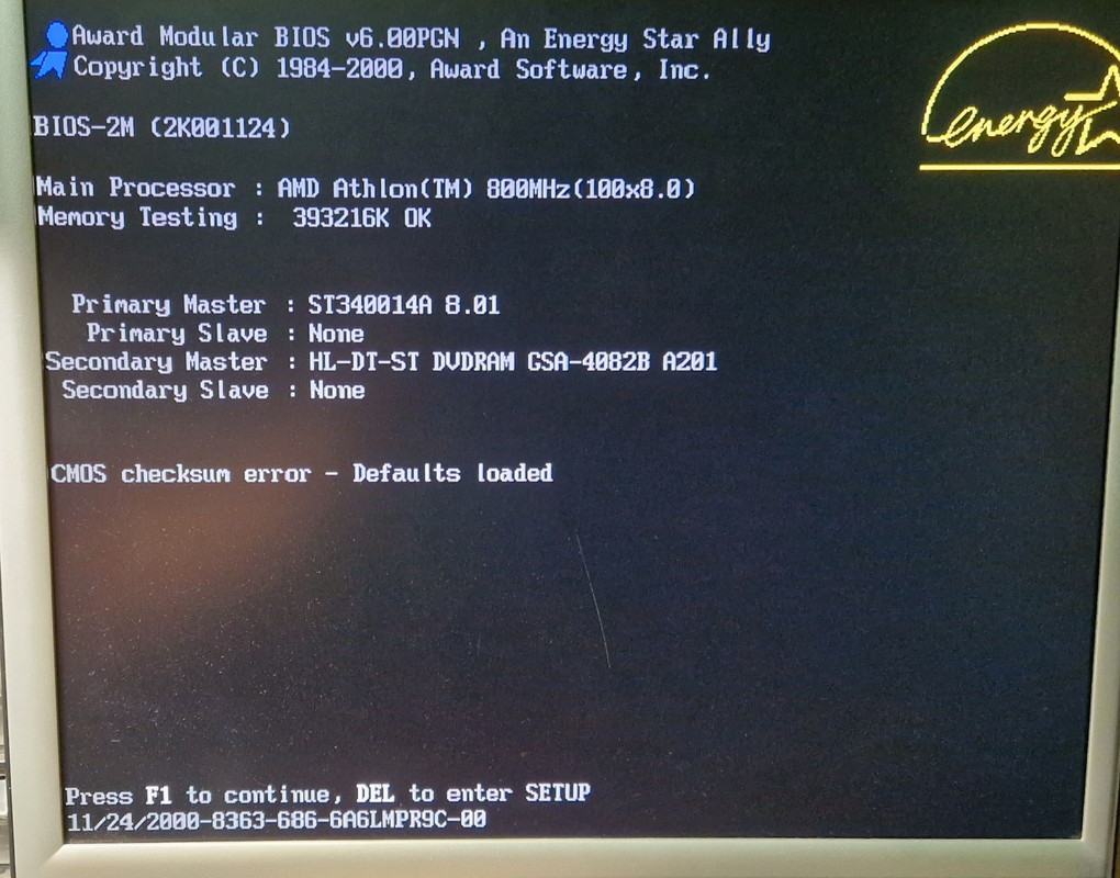

Hi, I got a retro computer from 2001. I refurbished it and am going to install a 9x OS, but I am having trouble identifying my hardware. This socket-A motherboard has an AMD Athlon 800, but no model number printed on the PCB.
I found a sticker on the ISA slot with the code PM-K911A-ASO and when I searched for it on google I only found a link https://www.elhvb.com/supportbios.info/Archiv … /EQS/index.html that looks like a listing for EQS motherboards. There is no further information.
The board has the VT8363/VT82C686A chipsets and an Award BIOS with the infamous Phoenixnet adware.
I would like to have the manual for the board and the drivers and maybe you can help me. I have taken some pictures. Thank you very much.

a search for the bios string brings me here . https://theretroweb.com/motherboards/s/pcpart … 1-35-8911-xx-xx
PCPartner K133ASA-911 (35-8911-xx-xx)

Great! That's the motherboard! There's even more than I expected to find. Thank you very much. Awesome.
