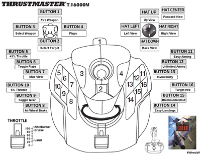

The Z-Axis throttle support sends "Throttle" game keyboard commands to the game
based on the position of the joystick's Z-Axis throttle:
Z-Axis Position > 80% (throttle slider down) = Key Sent: 1 (0% Throttle)
Z-Axis Position > 60% = Key Sent: 2 (25% Throttle)
Z-Axis Position > 40% = Key Sent: 3 (50% Throttle)
Z-Axis Position > 20% = Key Sent: 4 (75% Throttle)
Z-Axis Position > 5% = Key Sent: 5 (100% Throttle)
Z-Axis Position < 5% (throttle slider up) = Key Sent: 6 (Afterburner)
The POV/Coolie hat support sends "View" game keyboard commands to the game
based on the position of the joystick's POV/Coolie hat:
POV Centered = Key Sent: F1 (Forward View)
POV Down = Key Sent: F2 (Back View)
POV Left = Key Sent: F3 (Left View)
POV Right = Key Sent: F4 (Right View)
POV Up = Key Sent: F5 (Up View)
The joystick buttons support sends several standard game keyboard commands to
the game depending on which joystick buttons are pressed:
Joystick Button 3 = Key Sent: ] (Select Weapon)
Joystick Button 4 = Key Sent: f (Toggle Flaps)
Note that these buttons are normally assigned in the game for a Thrustmaster
Flight Control System, but need to be reassigned for a standard joystick.
The joystick buttons support also sends several additional game keyboard
commands to the game depending on which of the remaining joystick buttons are
pressed:
Joystick Button 5 = Key Sent: 8 (+5% Throttle)
Joystick Button 10 = Key Sent: 7 (-5% Throttle)
Joystick Button 6 = Key Sent: f (Toggle Flaps)
Joystick Button 9 = Key Sent: g (Toggle Gear)
Joystick Button 7 = Key Sent: F9 (Map View)
Joystick Button 8 = Key Sent: b (Toggle Air/Wheel Brakes)
Joystick Button 13 = Key Sent: CONTROL+I (Toggle Invincibility)
Joystick Button 12 = Key Sent: CONTROL+U (Toggle Unlimited Ammo)
Joystick Button 11 = Key Sent: CONTROL+E (Toggle Easy Aiming)
Joystick Button 14 = Key Sent: CONTROL+L (Toggle Easy Landings)
Joystick Button 15 = Key Sent: CONTROL+B (Toggle Blackouts/Redouts)
Joystick Button 16 = Key Sent: CONTROL+T (Toggle Target Information)
Note that the layout assignment and organization of these joystick buttons are
primarily for use with a Thrustmaster T.16000M joystick, but can be edited for
any other joystick that has 16 buttons. Additional joystick button assignments
can also be added or removed from this AutoHotkey script depending on the type
of joystick that is used.
Lastly, note that the assignments for joystick buttons 1 and 2 for the default
standard "Joystick" and the Thrustmaster "Flight Control System" joystick in
the game are the same (hence they are not assigned in this AutoHotkey script):
Joystick Button 1 = Key Sent: SPACEBAR (Fire Weapon)
Joystick Button 2 = Key Sent: ' (Select target closest to center of the screen)
ENJOY and HAVE FUN!
Rich ¥Weeds¥ Nagel
November 1, 2024
Here is a printable template for use with a Thrustmaster T.16000M joystick with Chuck Yeager's Air Combat running under DOSBox with the AutoHotkey script:
