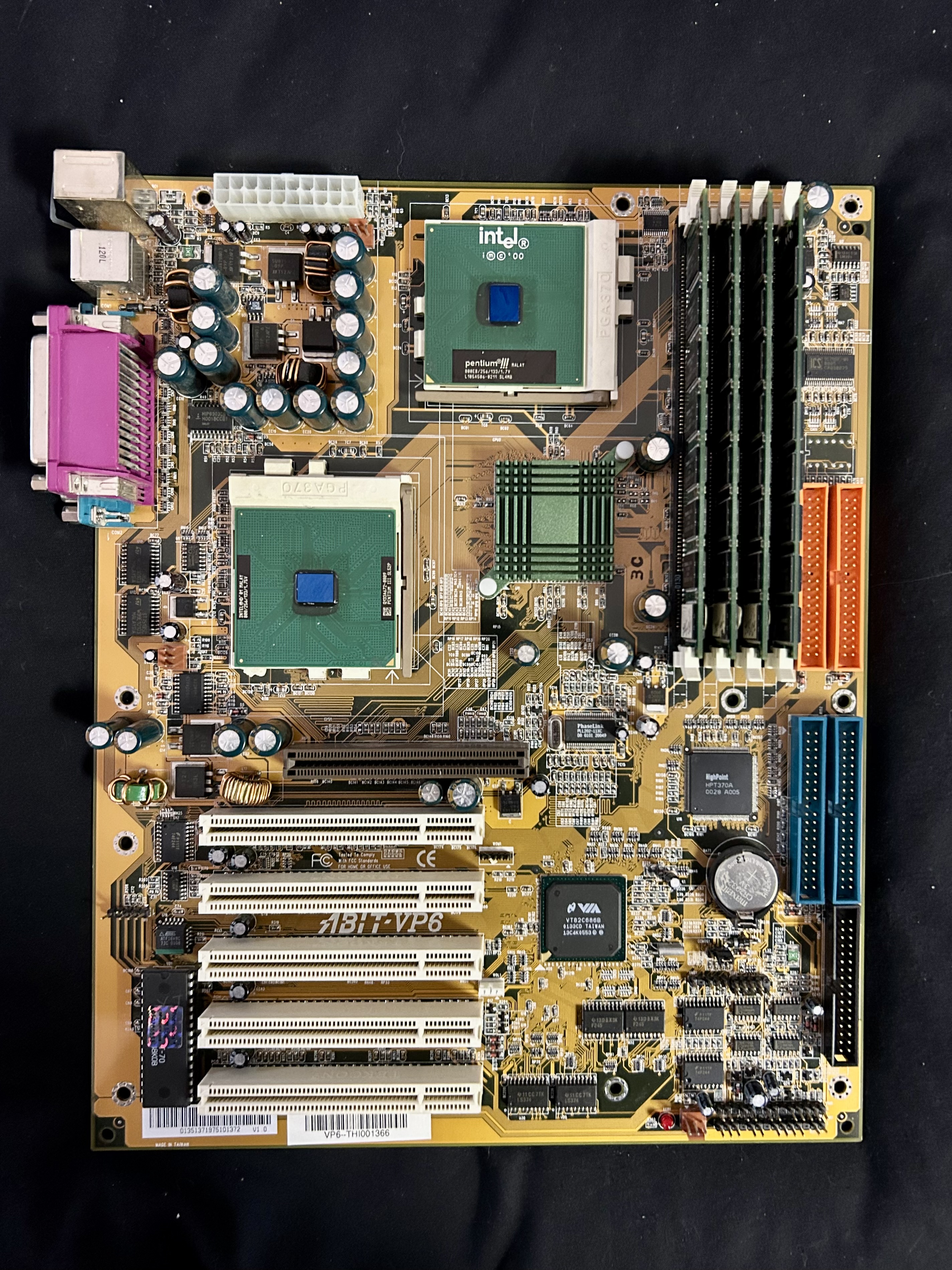

How did I do?
First post, by SYZYGY
AB-VP6
https://theretroweb.com/motherboards/s/abit-ab-vp6
Processors on the board:
SL4MB
https://www.intel.com/content/www/us/en/produ … ifications.html
SL52P
RAM on the board:
3x 32MB SDR 133MHz
1x 128MB SDR 133MHz
A very good friend of mine, who is not into retro computing, gave this to me. Works perfectly.
What processors would you put in it? Can it take two of the Pentium III Tualatin Pentium III 1400S processors? I know this board has a 133MHz FSB and so does the Pentium III 1400s
This motherboard ran Slackware Linux it’s entire life as I have plenty of computers running Linux I am thinking to run Windows 2000 (as it has SMP) does anyone know if Haiku 32-bit has SMP? I believe Arca OS supports SMP.
I have two Voodoo 3 graphics cards (dunno what model of Voodoo 3 they are) from this same friend… I think it would be cool to run them both at the same time, but i don’t know if Windows 2000 ever ended up supporting SLI… might go with Windows XP Pro as I understand it supports SMP and SLI (correct?). I also need to find out if Arca OS and/or Haiku 32-bit support SMP and SLI… your suggestions welcome!
I have a RIVA TNT2 graphics card I will probably use with it until the Voodoo 3 cards arrive.
For storage 1 have 2 128GB mSATA SSDs in this adapter 2.5” adapter: https://www.amazon.co.uk/gp/aw/d/B01GR ... asin_title
This board maxes out at 2GB RAM so any suggestion on what 512MB RAM sticks I should buy?

You can't do SLI with voodoo 3, but you could with voodoo 2's. You could even use a voodoo 3 as a 2D card and a pair of voodoo 2's as the 3D option, if you're crazy enough.
I don't see why this board wouldn't support tualatin but you will need to find the pentium III-s cpu's as those are the ones that support SMP.
Might need a bios update though.
Any pc 133 ram is probably fine, I would imagine.
Another cool thing about this board is that it's got a raid controller for raid 0/1.

The ABIT VP6 officially doesn't support Tualatins because it has the VIA Apollo Pro 133A (VT82C694X) - you have to modify it or use adapters for that. Tualatins are supported by the successor VIA Apollo Pro 133T (VT82C694T).
See also the ABIT VP6 spec page on my website -> https://soggi.org/motherboards/abit/VP6.htm.

Tualatin... Might be a problem

Thanks for the information! I assumed incorrectly that all Voodoo graphics cards could use SLI! Goo to know!

Thank you and cool website! I want to run 2 processors at the same time… what are the 2
fastest PIII processors I can run on the VP6 without modifications or adapters?
THANKS!

That's correct AND incorrect! You can't do SLI with two single Voodoo3 cards (because of the missing hardware on the cards themself and for the AGP versions because of there's just one AGP), but the Voodoo3 GPU (codename Avenger) is SLI capable like every Voodoo generation (except Banshee!?). In theory you could put two, four, ... Avengers together on a board like 3dfx did it with their VSA-100 GPU Voodoo5 5500 and 6000 (VSA100 GPU) - Quantum3D did so on a prototype board.
SYZYGY wrote on 2024-12-09, 18:50:
Thank you too, you're welcome! The fastest socket 370 Pentium III Coppermine CPUs - supported FSB in brackets - are 1000 (100), 1000B (133), 1100 (100), 1133 (133). The 1000 MHz versions should be easy to get, the others could be more or less hard to find (just my guess).
