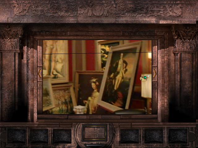

Hello,
I've noticed that many of the old DOS games that I run in DOSBox have very bad (noticeable) screen tearing. In newer games (i.e. Windows games) this screen tearing can be fixed by enabling vertical sync through the video card drivers. However, even with vsync enabled through the vid card drivers, the screen tearing in still apparent in the game when run in DOSBox. Is there a way to remedy this screen tearing?

Qbix, are u referring to the doublebuffer option? is that the vsync option?
HunterZ, its not a problem with the game running too fast so cycles have nthing to do with it....it a problem with the screen tearing (or breaking in half slightly) when you scroll side to side....
for example look at the attachment below...the black line i put in there for emphasis but it is an example of screen tearing...see how the black line splits the screen into two section? in the game it is not a black line, the line is the same color as the surroundings....

Qbix & WhiteKnight: I think this tearing is not due to emulated vsync inside of DOSBox but rather the final rendering on the host OS side (e.g. Windows). I really think it should work to use Direct3D or OpenGL output and force vsync on in the video drivers, unless the video drivers are broken/stupid and don't do it even if you set them to. Try Gulikoza's DOSBox CVS with output=direct3d (not the same as ddraw) and make sure you have your video drivers set to force vsync enabled in Direct3D apps (not just default enabled)
