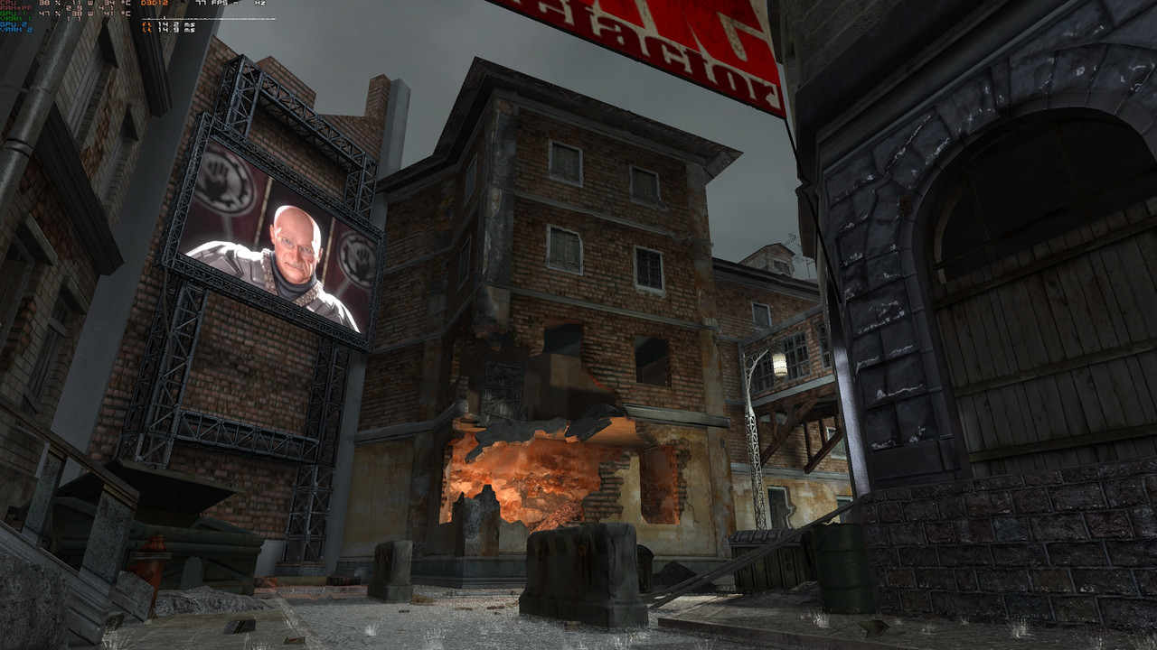

in Timeshift + D3D12 I simply don't have the menu 2D elements (the entries of the menu). No problem in D3D11 (but maybe there's a problem with the barrel explosions)
System with Win11 24H2 + Arc A380 and lastest drivers.
Loading screen too (before the menu) is missing, so clearly there's a problem with plain textures.

No problem here with the menu. It feels like certain texture allocations fail for you. You could check out the dbg layer of dgVoodoo here, or should isntall and look into the dx12 debug layer.

no warnings/errors in the dbg stream of dgvoodoo....

Weird. 4G aware maybe? But it shouldn't be the problem...
Btw, I have version 1.0.0 of the game.
You can try an older version of dgVoodoo, that worked previously, to see where the problem is.
