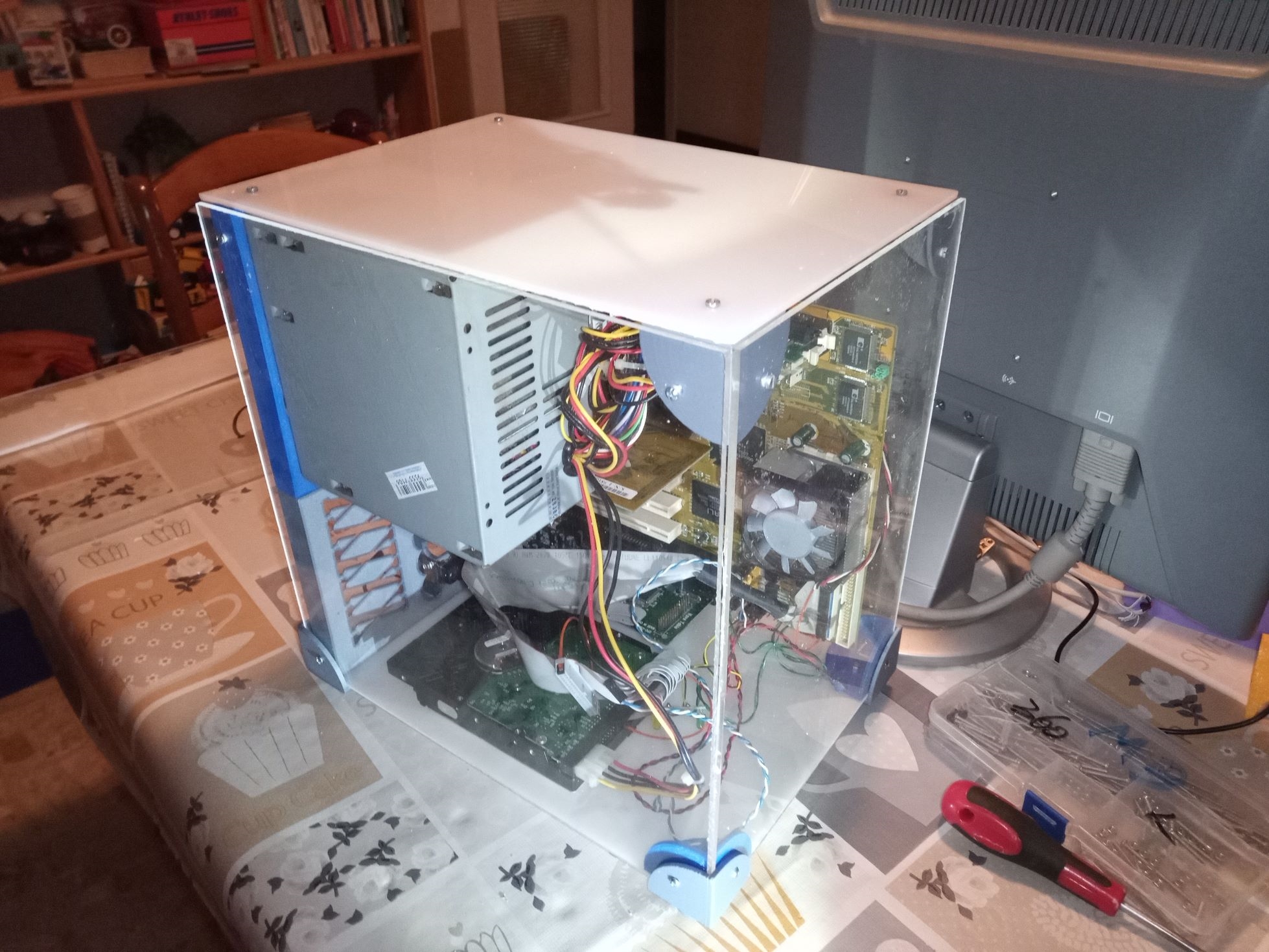

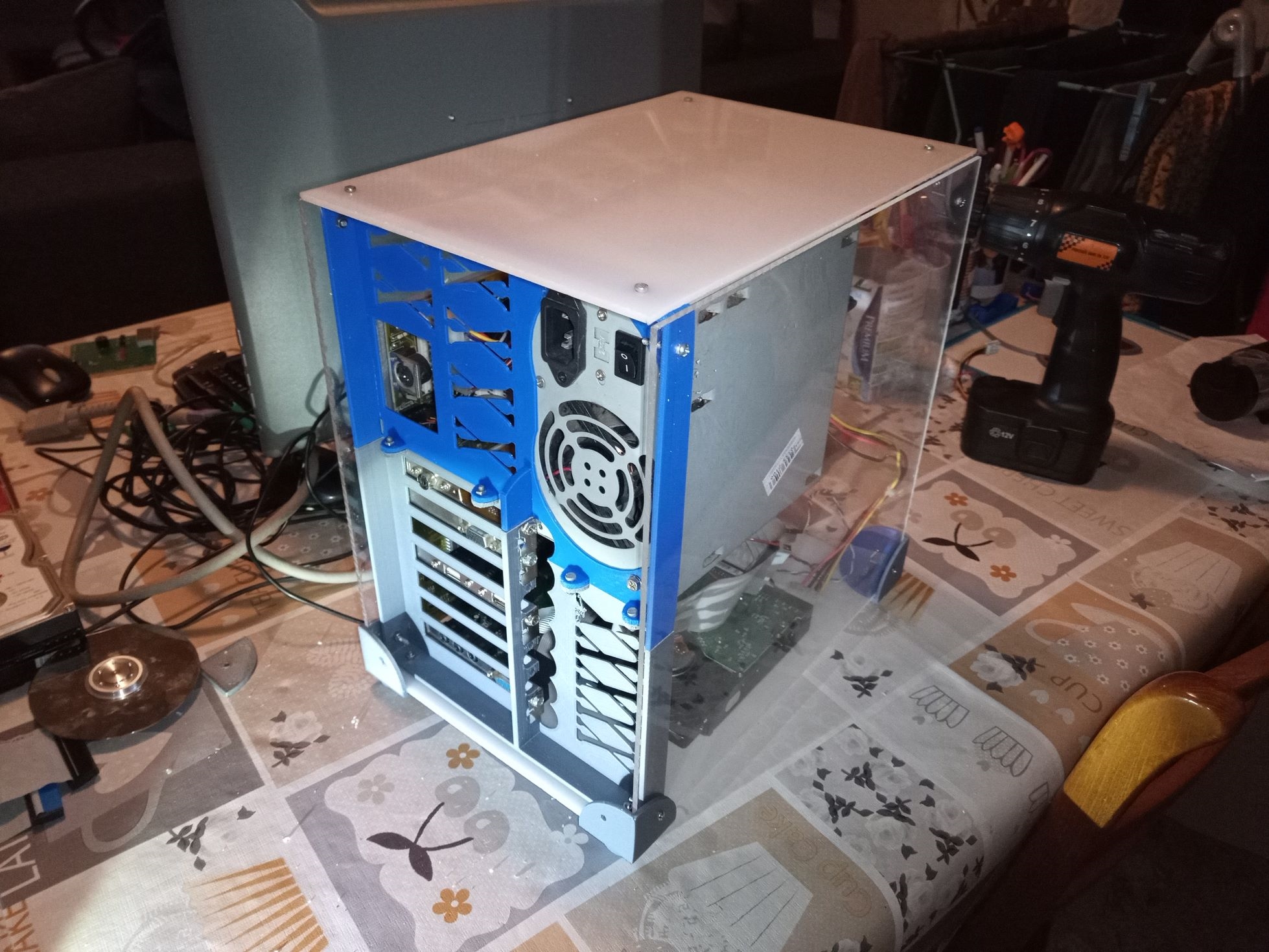

I've searched high and low on the internet for a 3d printed BABY AT case with no luck...
So I've made mine.
All the details are on the printable.
It's far from perfect as on the use side, as on the build itself.
But at LEAST it now exist so peoples can improve it !
https://www.printables.com/model/1146501-baby … with-atx-supply
342501 342499 342500

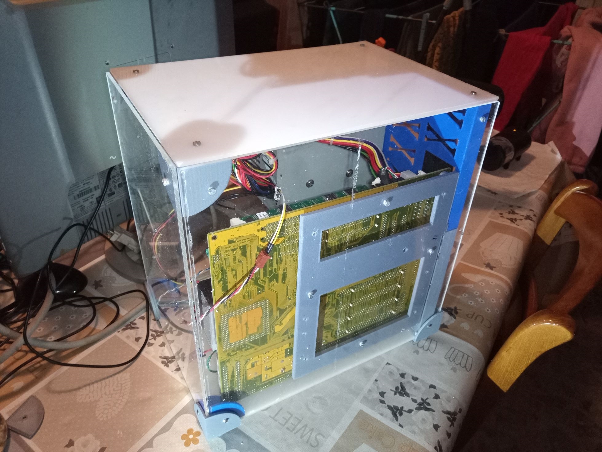

Reply 1 of 4, by crazytiti
I have updated the model.
The hdd rack is screw ion the upper part.
It has a support for the PSU.
Everything is on printable.

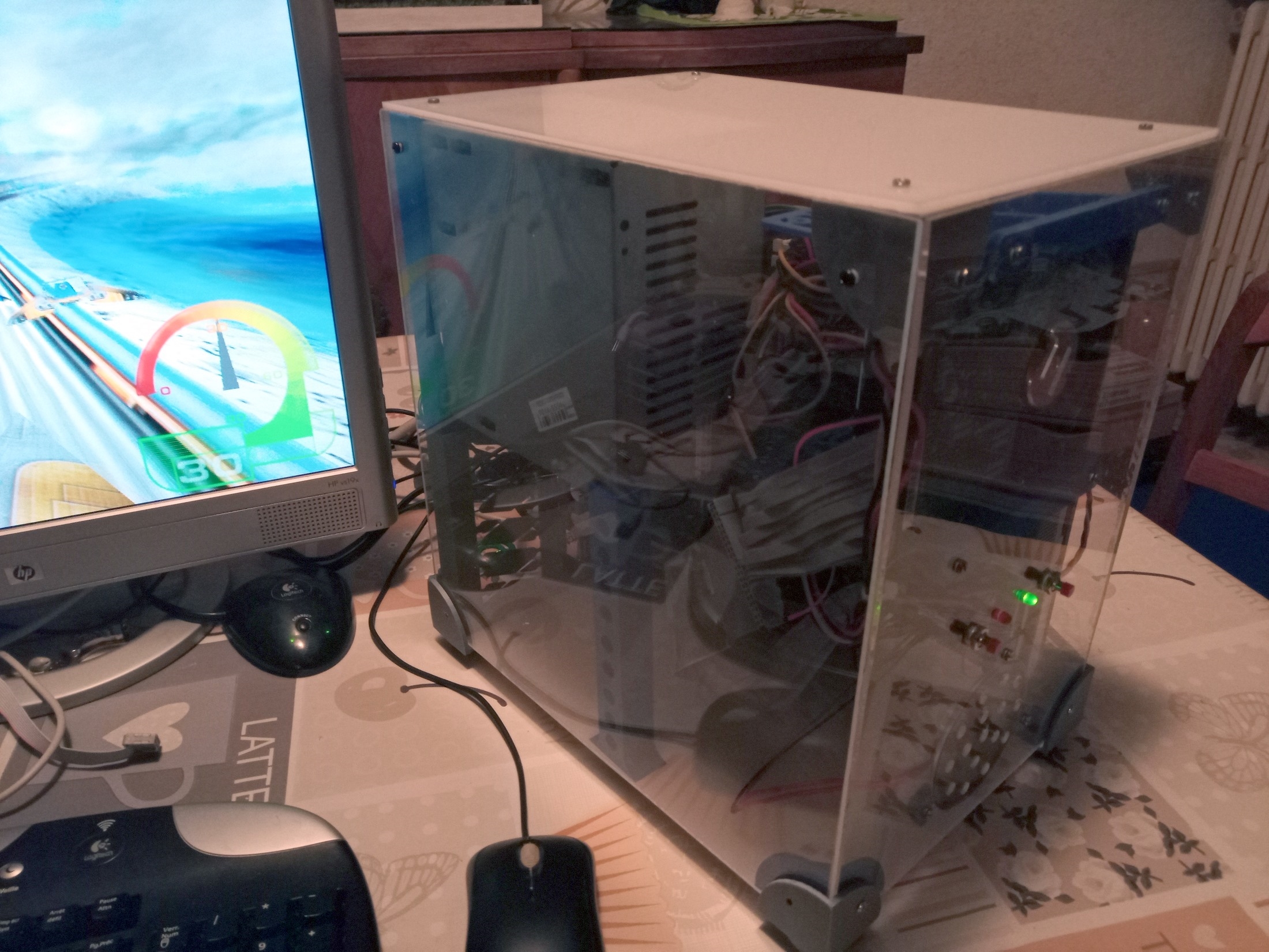

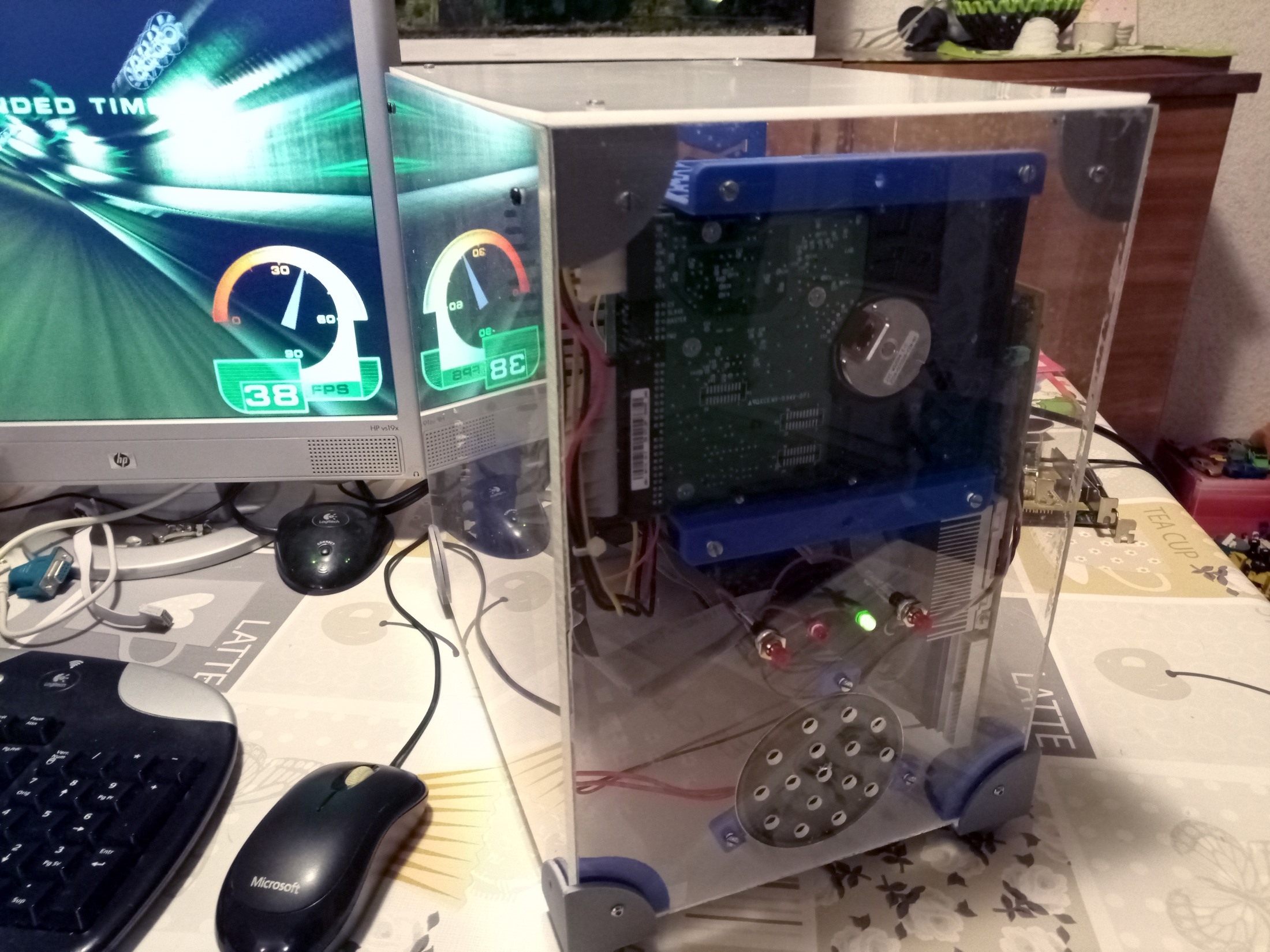

Reply 2 of 4, by crazytiti
I've added a support for the PSU, the speaker and led/button.
It's very usable now.
It may need some adjustment on the rear bracket but i found good enough for now.
345877
345878
