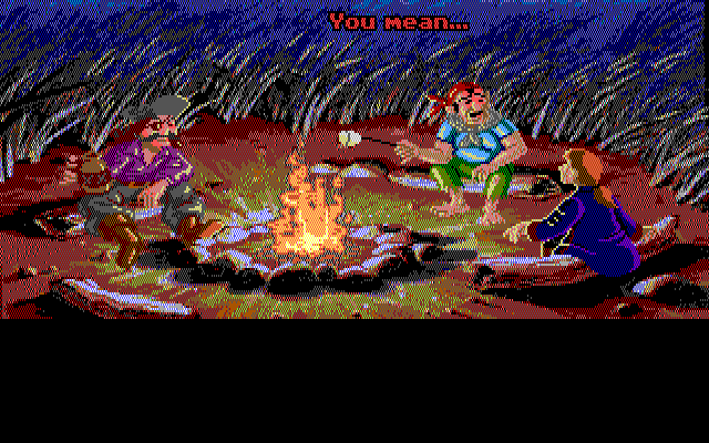

Postby vasyl » 2005-11-10 @ 18:29
Which version do you have? The version that comes from Monkey Island Madness collection does not work properly, showing black and white. Does exactly the same on the real system. Interestingly enough, according to debug log it uses mode 2. I vaguely remember that there was some trick that allowed to create non-planar 320x200x16 mode. I'll have to take a closer look.

Postby vasyl » 2005-11-11 @ 06:36
Found different version of Monkey Island 2. Just great:
Interpreter version 5.2.28cd (9/6/1996) -- does not work.
Interpreter version 5.2.02 (11/21/1991) -- works fine.
The first (28cd) version is probably the most common, it is included in Monkey Island Madness collection. I don't even know if that version actually works on the real EGA. Quite possible that somebody broke EGA support while updating the interpreter (removing manual check, adding MT-32 port settings) and no testing was ever done. For some reason the broken graphics looks suspiciously like Hercules. Probably, just a coincidence.

Postby vasyl » 2005-11-12 @ 04:35
No effect. Actually, Monkey Island 2 never writes to 3c0 or 3c1. However, there is something interesting going on PEL data port (3c9, vga_dac). The new (broken) version loads apparently monochromatic palette into that port. The older version never writes there. That port is VGA-specific, right? So, the game is intentionally broken on VGA cards???
vasyl

Postby vasyl » 2005-11-12 @ 07:29
Beats me. That behavior in MI2 does not make any sense. I've just tried that thing -- blocked all writes to 3c9 from the game. The game works and looks fine after that.
I did not patch the executable itself, modified vga_dac.cpp instead. If you try that don't forget that all calls originated from int10 should go through. There are a lot of calls so I just added static variable and changed after the mode change.
EDIT: Patching the executable works as well. Assuming that you have the same version as I do, this should work:
0001030C: EE 90
00010316: F2 90
00010317: 6E 90
I expected this to break VGA but it did not...

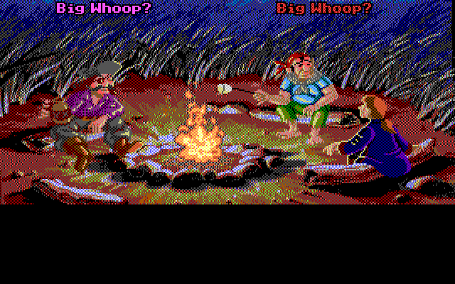

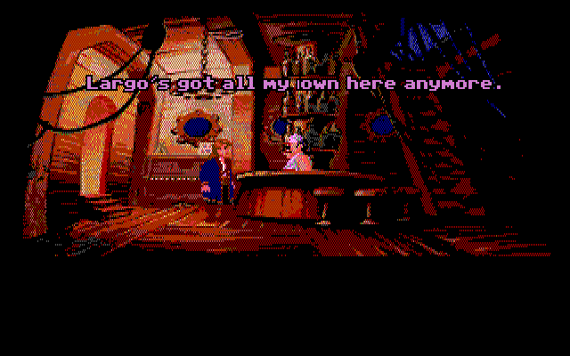

Postby Great Hierophant » 2005-11-12 @ 17:45
Well, the patch seemed to work for me as well. I have version 5.2.28cd (9/6/1996). However, I did notice an odd behavior for the dialogue text of some characters during the game, and I wonder if this is intentional or not. See the posted screenshots, below.
This is another example of a character who exhibits the odd text, but it should be common throughout the game.
Here, you can see the difference. Use a magnifier if necessary.
In the EGA mode, the text usually appears just like in the VGA mode, but look at the text of this pirate.
