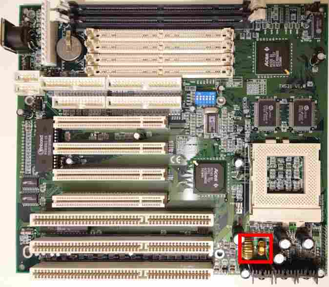

I've got the board and was able to run it for a while. But unexpectedly it died. Then I realized that someone cut off two inductors, marked on the photo. Next I did measurements of CPU voltages because installed CPU does not become hot without radiator installed. Measurements shows that MMX got only VCC3 core voltage of 3.26V and VCC2 I/O is 0V. Non-MMX is even worse because both voltages floats under 1V. Then it looks like CPU Power Line is damaged now. Anyone has this board and can tell me what inductors should I mount there?
BTW: if you happen to have this board and it stuck on WAIT message or immediately after, then check jumper JP8.
