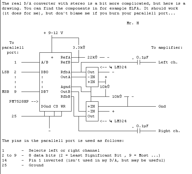

This initial question sounds familiar. A number of DOS era demos used fairly simple circuits that you could build yourself for stereo sound via LPT. Some of them don't like the emulated Sound Blaster, or even a genuine SB16, and for any kind of decent sound, they rely on these circuits you can build yourself. It would be nice to see support for these D/A circuits added to DOSBox.
I found a scematic for these circuits in the documentation for a demo. Screenshots are attatched. Both are from the same document.
    4.42 KiB
    1914 views
    Stereo schematic
