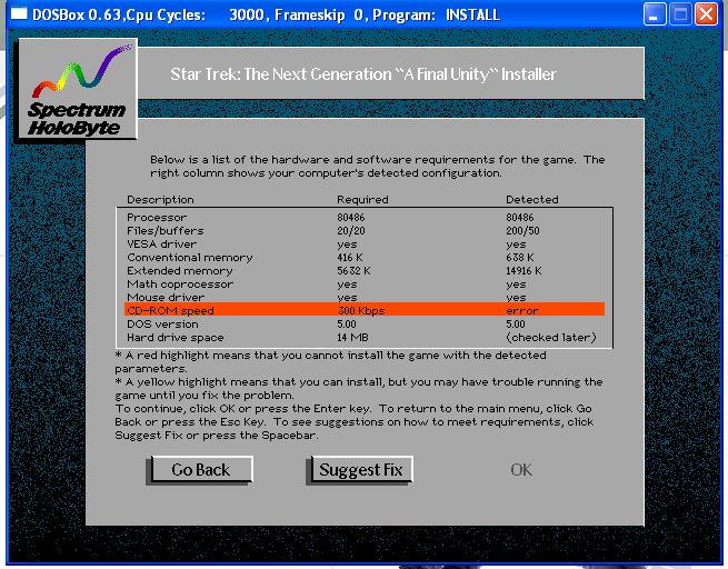

hello everybody!
yes i am a noob when it comes to dosbox so if this has been asked before, i apologiza in advance.
anyways im trying to run an old game and i get the installer to run then it runs gives me an error that says it required a cd speed of300kbps when im quite sure my drive has quite more speed than that, it doesnt say i dont have a fast enough cd it just says error
so any fixes to this problem?, suggestions, links to old posts?, anything will come in handy
thats u in advance, cos ive been searching and i know u r the pros!
oh ill try to put up a screen shot of the error hope u can see it
    84.31 KiB
    1445 views
    this as u can hopefully see is the error i get

First of all, running DOSBOX at 3000 cycles for a game that was made for a Pentium ???? Get that up to 30000 at the very least!!! And use Dynamic mode! And use DOS32A extender! Go to the big Final Unity topic for more info, but do all these things first and THEN try to install it - the low cycles may be why it won't read your CD correctly.
Reply 2 of 5, by eL_PuSHeR
Try making an ISO or BIN/CUE (if several tracks) image from the CD and run it from a virtual drive.

I think that there was a patch for the installer that addresses this. Search the forum.

hey thanx for the reply, i cranked it up to 30000 cycles but could u give me the low down on how to enable the dynamic mode and the DOS32A extenders, there seems to b no info bout that in the dosbox readme file...

I don't know if it's related, but Fade to Black also sees CD's mounted in DOSBox as single-speed. I had mounted an actual CD directly in DOSBox. Fortunately F2B has a poorly-documented feature to override the speed detection.
