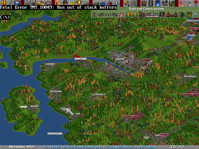

Is it normal that the XMS support is not working in the CVS Builds?
I've tried the AEP, gulikoza and ykhwong CVS builds and all of them have the very same problem: trying to run ANY programs (except some readme scripts) with XMS enabled just give no response: any application just goes back to DosBox Command Line, without any error message.
Even a clean build done with the sources taken from http://pcnwstage.phys.rug.nl/ (just bare emu, no png, no SDL_net, nor SDL_sound) and MSYS give the same wrong behaviour.
DosBox 0.63 gives no problem, even with xms enabled.
At the same time , some applications entirely stopped working: stunts (patched with neverlock) gives back an error message while it ran perfectly with Dosbox 0.63 (look at the screenshot)
Any Idea?
By the way, I'm using a Duron 1400mhz with 512 MB of RAM, Radeon 9250 with the latest drivers and an Asus Nforce A7N266-VM (latest driver and bios, too) on winXP SP2

Reply 3 of 8, by Sal Z
You are right, it's keyb.com fault.
Well, to say it better, it's while using keyb.com that the problem arises, while it was perfectly fine with dosbox 0.63.
using "LOADHIGH keyb it" solves the problem , or just version 2.00 pre-release 4 fixes it.
very weird.
Anyway, if someone wants to take a look, here is it.

Reply 5 of 8, by Sal Z
pr3 works fine, and pr4 as well i think.
Sorry if I sound rude, but...are you sure of that?
I mean, actually it's the pr3 release of keyb.com that creates such memory problems, and the pr4 Changelog says clearly:
FIX: Correctly restoring the allocation strategy (bug notified by the DOSBOX team, THANKS!)
that seems like the situation shown here!
In any case, I 've not used the pr5, and i'm surely not going to use it and maybe break other things. 😀
Reply 7 of 8, by wd
Rank DOSBox Author
DOSBox Author
The analysis is still around somewhere, the bug i'm talking of is in
the UMB handling of keyb. As dosbox0.63 doesn't have UMBs, this
will not be noticed.
Yet pr3 worked fine for me, but of course it could be that something
is broken in dosbox. Or maybe i'm confusing the version numbering
of keyb somehow 😉
