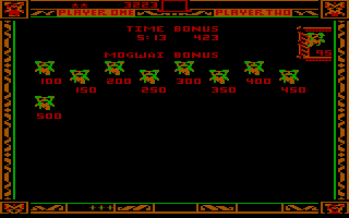

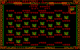

Completing 'Night 1' in Atarisoft's Gremlins inside DosBox 0.65,
results in the endless bonus of Mogwai. It initially counts down from the actual number you saved during Night 1. However, once reaching zero, it bumps the saved number to 99 and procedes the countdown bonus for saved Mogwai. The process continues in an endless loop.

*NOTE: Results are the same if I set the machine to either cga or vga. Though with vga the intro music to the Night/Level lags behind.
Please see the attached screenshots.

Reply 1 of 8, by trebor
OK, I found using core=dynamic fixes the problem. Any thoughts as to why core=normal does not work? BTW, core=simple and core=full do not work either. The results are the same with simple and full as what is experienced using core=normal.
Reply 7 of 8, by wd
Rank DOSBox Author
DOSBox Author
Yes, thanks, already found it 😀
The game already works with all cores as i fixed some (unusual)
flags stuff of the normal/full core some weeks ago. The dynamic
core runs the game fine for the 0.65 release, as you said.
