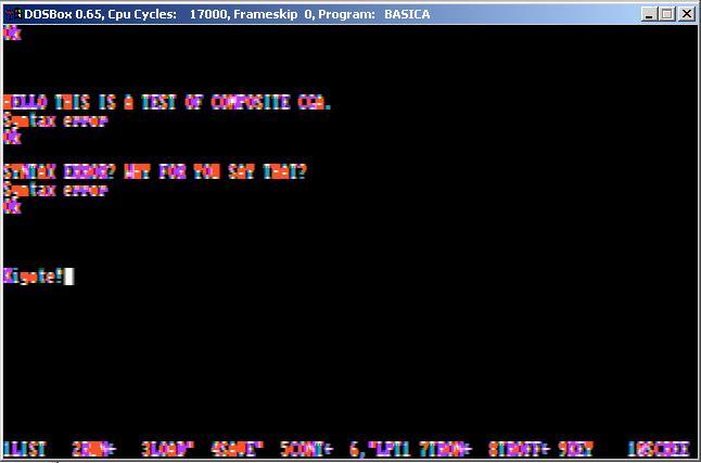

Since this is a luck of the draw, so to speak, I thought I'd show proof that my utility does do something to give some hope.
Here is a screenshot of Tandy EX Basic, running on a 640x200x2 screen, under composite emulation.
Upon running DOSBOX, I ran my utility, then the BASICA.EXE file.
GWBasic.EXE however, would not take this same method. It shows the composite screen for a second, then switches over to regular CGA with no colorburst.
I only have Dosbox .65 running on my computer right now, because I have bad drivers which crash .63 and .72 on me. I can't test this on other versions of DosBox right now.

    CGA Composite emulation using CMPOSITE.EXE to enable it
