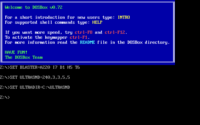

Thanks--I followed your suggestions of setting core=dynamic, cycles=auto, and nosound=true in the dosbox.conf file, and the game is way faster. However, after I got to a certain point (farther than I have ever gotten without a crash), I received a "Page Error" message. Attached is a screenshot containing the error message.
Reply 7 of 9, by wd
Rank DOSBox Author
DOSBox Author
> nosound=true
This only disables the sound output, not the soundblaster emulation
itself (this would be sbtype=none instead of sbtype=sb16).
About the crash: don't know, real mode callback doesn't sount too
good, maybe use loadfix before starting the game.
