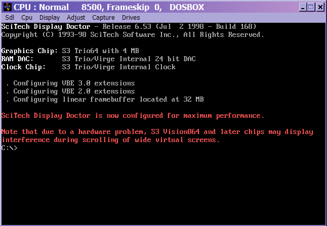

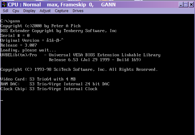

Application Gann Trader (graphical) that run under DOS cannot run on resolution higher than 640x480 (the base resolution) under XP nor under DOSBox. It works perfectly under Win98.
Apps has a utility that check the video card and recognizes the cards emulated by CVS: S3 and ET4000.
Best results are achieved with S3 where the app swallows the hi-res settings and the dosbox window gets enlarged. But the picture in it stretches instead of showing more pixel!!

S3 gives best results enlarged window
all the others cards have the effect of ignoring the resolution change.
DOS box CVS just downloaded
Dosconf is attached. I dont think I messed around with it except svga
thanks
see you tomorrow
L

    recognizes S3
    23.08 KiB
    1577 views
    Just before it starts with the S3

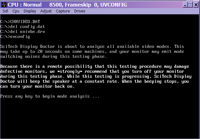

Reply 8 of 19, by eL_PuSHeR
Done!
Execute and configure program and replace univbe.drv with this one (a hacked version).
Forgot to mention this program is quite stupid. Program is ms-dos only but the installation comes as a Windows one. (For creating shortcuts).
Also, this program works fine for me without using DOSBox (using NTVDM).
Also, keep in mind that you won't be able to PRINT using the official DOSBox 0.65 build. You need some printer enabled CVS version for that. I think HAL-9000 did something like that.
PS - DOSBox maximum implemented VESA resolution is 1024x768.
    UNIVESA_MODIFIED.RAR
    1.36 KiB
    166 downloads
    UNIVESA MODIFIED. Extract the 53.DRV file and rename it to UNIVBE.DRV
    2.79 KiB
    140 downloads
    Example screen configured at 1024x768 (Program can go up to 1280x1024 - or so it seems)

The main executable uses DOS4G and it seems it has univbe embedded into it. At least there is a "univbe.drv" string present. I will try to disable it to see what happens.
UPDATE:
Removed the univbe.drv string by hacking it using a brute force method (I am not a programmer). I simply replaced some characters in the string.
THE PROGRAM IS STILL WORKING WELL (1024x768 with DOSBox and 1280x1024 using NTVDM). GOOD NEWS IS THAT IT DOESN'T NEED UNIVESA ANYMORE. Stupid programmers.
Ouch. Two in the morning. I have got to get some serious sleep.
Good bye for now.
UPDATE 2:
Program also works fine when you DELETE the univbe.drv file. This is a even easier method. You don't need to modify anything. Again, stupid programmers.

Reply 13 of 19, by eL_PuSHeR
ldd2871
As we are talking above, just DELETE UNIVBE.DRV after configuring the program. Then, run it as usual. It should work. You don't need any kind of external VESA anymore. DOSBox has built-in VESA bios extensions (up to 1024x768 resolution).
Intel i7 5960X
Gigabye GA-X99-Gaming 5
8 GB DDR4 (2100)
8 GB GeForce GTX 1070 G1 Gaming (Gigabyte)
