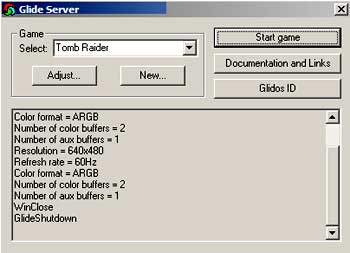

Reply 15 of 21, by Glidos
AntiSnipe wrote:
Bah! At the end of Sanctuary Of The Scion, it crashed to desktop again. I give up. I'll just have to keep kicking it in the a** and deal with it.
Last message "GlideShutdown" That suggests that TR decided to shutdown. Odd.
If you find time to do more tests: could you go back to the version of PollPipe.dll that comes with v1.22 and set up TR with no audio support. See if that cures it. I know that is a useless way to fix it, but it might tell us something.
