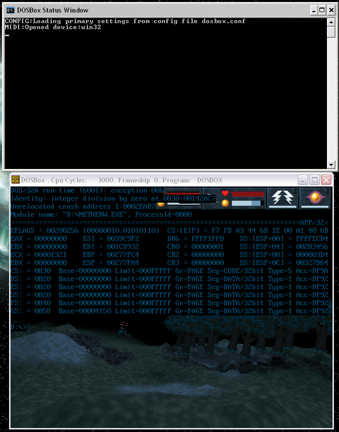

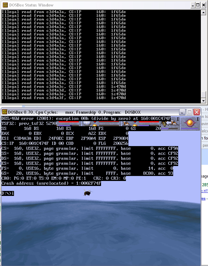

Dosbox 0.70
Running Magic Carpet 2 in High Res with:
CPU Core set to auto
Cycles set to auto
Priority set to normal
Memory set to 16 mb
VGA mode
I have one problem:
1.) After around 15 minutes of play the game crashes in this manner:
- The Dosbox status window starts spitting out tons of "Illegal Read" messages as in the attached picture.
- After a bit of this the game freezes with an overlayed error message on the Game Screen, as pictured.
This crash occurs in both networked and non-networked games.
Things I have tried:
Changing CPU Core to dynamic - Didn't change anything
Setting Memory higher - Augmented problem
Running in Lo Res - Didn't change anything
Changing Priority to Higher - Didn't change anything
Closing background applications - Didn't change anything
Using Dos32a extension instead of Dos4gw - Illegal Reads and crash occured a few minutes later than Dos4gw
Is there any way to prevent (or at least delay) this crash?
I have seen on this forum one method that prevented crashes referenced a few times where a pure non-usb mouse is used. Is this a plausible solution to this problem?
One note that may help people more knowledgeable on this subject:
I am running Magic Carpet 2 on two computers (to network), and one is faster than the other in both CPU speed and Hard Drive speed. The faster one takes longer to crash, but not much longer.
    384.77 KiB
    2115 views
    Dosbox when the Magic Carpet 2 crash occurs.
Reply 1 of 25, by ADDiCT
Ah, Magic Carpet again... (;
I've played through the game in Lo-Res mode some days ago (my rig is not fast enough to handle SVGA smoothly), without one single crash. Knowing that MC2 is considered a very buggy game (see the Wikipedia entry on MC2), i was impressed by the stability.
Here's my setup:
- DOSBox 0.70 latest AEP CVS (you should try this first!)
- DOS/32A
- Dynamic core, fixed cycles (the max number of cycles my machine can handle)
- SB16 for sound, General MIDI for music (you should check if the setup program uses the right IRQ, DMA and IO settings - sometimes, setup programs will auto-detect wrong settings)
Hope that helps...
Reply 2 of 25, by KadeshSa
Thanks for the reply!
I was clueless about this. I'll see if I can get that and see what effect it has.
Edit: Are you referring to the build from here?
http://cvscompile.aep-emu.de/dosbox.htm
I can't get ipxnet commands to work on that build, making it impossible to play networked games. Do I have to get a patch or something?
In general though, now that I have tested it some, it does appear to work better. I did still recreate the crash in single player, but no Illegal Reads occured and I was able to play through 5 levels twenty minutes per level. I attached a screenshot of the crash.
I actually tried dynamic core to no avail, but I haven't tried fixed cycles. Once I have the latest AEP CVS this is what I'll mess with first.
And it looks like my sound settings match yours, so hopefully there are no problems there.
So is switching to High-Res mode the same as switching to SVGA mode? Because one thing I noticed while browsing among Dosbox patches were things messing with SVGA modes, and the raw Dosbox 0.70 download has no options regarding SVGA.
Also, there is no reference in Dosbox 0.70 to the emulation of a video card. A video card is actually recommended in the Magic Carpet 2 Readme file. Could this be anything?
Again, thanks for the help, I was beginning to think that I was on my own.

Reply 3 of 25, by ADDiCT
Sorry, i should have included the link to the AEP pages in my post... Yes, i'm referring to that build. Can't say anything about IPX, though, as i haven't tried it yet. You shouldn't need any additional patches with this build. Maybe IPX is broken with the build you've tried - you could wait some days, and download a new build afterwards, to test it (they are building the executable daily AFAIK). You could also try using the AEP build with the SDL DLL's from the official 0.70 DOSBox build (i have to use the original SDL.dll to get DirectDraw to work correctly). For IPX, i'd try to change SDL_net.dll.
By "high-res", i mean the SVGA mode. I'm not quite sure about DOSBox's video card emulation, but AFAIK it emulates a VESA video adapter. You can't change the type of emulated adapter, but there's Ykhwong's build, which allows changing the type of emulated video adapter. Ykhwong's build is quite different from the original and AEP ones, as it contains a lot of special patches. It may be worth to try that one.
You write that your sound settings do match mine, but have you really checked the IRQ, DMA and IO settings? With the MC2 setup application, you have to go through some menus to get to the screen where these settings can be changed. You should double-check these, as sometimes, games will actually work with the wrong settings, but may have problems later on.
You should also try fixed cycles, and finally the DOS32/A extender. For me, DOS32/A is a lot faster than DOS4GW, and it seems to be more stable in DOSBox. For finding the correct cycles-setting, just change cycles=auto entry in dosbox.conf to cycles=10000 or something similar. Start MC2, get into the game, and switch to windowed mode. Now watch your CPU utilization in task manager, and change the cycles with CTRL-F12 and CTRL-F11, until you have close to 100% CPU utilization.
OK, so there's still some things to try for you. Let's see if we can expand the time where you can actually play the game... 😀
Reply 4 of 25, by KadeshSa
So... I have tried most of this stuff. Here is my report.
Unfortunately, I couldn't get the AEP CVS build to work with ipx networking. This is essential, since the whole reason I'm using an emulator to run Magic Carpet 2 is to network games. Otherwise I can play it nearly flawlessly on an old 486.
I tried mixing and matching DLLs, and nothing seemed to enable the IPX commands.
This is a real shame too, since the build is much more consistent and stable with the game. With cycles around 112000 (is this too high?) my CPU hovers near 100%, and crashes take much longer to occur. When combined with dos32a it works even better.
Now, all these same settings on the regular .70 release of Dosbox don't help much, except for the dos32a extension.
I rechecked the sound settings, and they look good from what I can tell.
Now, all this stuff is on an Athlon 64 cpu. On the other computer I'm networking, which has two Opteron cpus, the game is much more stable on regular dosbox .70 (auto cycles, etc.) and regular dos4gw; so I haven't tried any of these things on it. The next thing I'll try is putting the dos32a extension on that computer and manually setting its cycles, just to see if the different dos extensions were speeding up the crash with incompatibility issues. However, I doubt this is a problem.
What I really want to do is get networking working on the AEP build, because from my play in single player it was obvious it was capable of lasting longer. Any ideas?
Oh, and I also still want to try using a non-usb mouse. I saw in another thread that someone's MC2 crash was prevented by just using a non-usb mouse.
