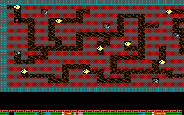

I am trying to run a game called Diamond Cave I wrote in the mid 90's. First of all, let me say that it is great to have this DOS emulation. I would not have imagined that I could see this game again, running under Windows XP! Many thanks.
Now, my problem is that the game runs great except for one thing. It uses an advanced VGA mode (text mode 259), which is text-based, but with replaced fonts (which are used for "blocky" graphics). It also has a scrollable upper part of the screen and a fixed lower part (split lines), which contains two lines that do not scroll and which are used to show game information.
In these two lines, as you can see from the attached screen shot, only garbage appears. There seems to be something wrong with either the font or the screen mode emulation.
I have tried with the other graphics drivers, but only VGA works for this game. I have not attached the game itself (1.3 MB), but would be happy to provide the game if anybody is willing to investigate the issue. I would also be willing to donate a small amount of money (20 Euro) for the resolution.
    5.25 KiB
    1558 views
    Screenshot

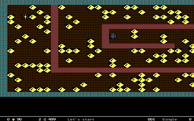

Reply 5 of 10, by DosFreak
It looks like it was fixed sometime between DOSBox 0.72 and the 6-1-2008 CVS
http://www.aep-emu.de/cvscompile/dosbox.htm
I just tried it in the latest CVS and it works fine.
    6.05 KiB
    1284 views

Reply 6 of 10, by h-a-l-9000
Rank DOSBox Author
DOSBox Author
2008-03-08 13:29 c2woody […]
* src/hardware/vga_draw.cpp: pel panning+line compare handled
different in textmodes, fixes diamond cave (thanks to hal for
spotting this)
