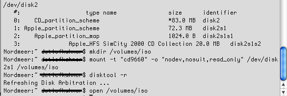

First of all, i googled and found the solution here:
Mount both the iso9660 _and_ HFS partitions of a hybrid CD
For short, open the Terminal app and enter the command
diskutil list
This will list all mounted volumes (quiote copied from the link above):
% diskutil list ... (extra results ommitted) ... /dev/disk2 #: type name size identifier 0: CD_partition_scheme Audio CD *29.9 M […]
% diskutil list
/dev/disk2
0: CD_partition_scheme Audio CD *29.9 MB disk2
1: Audio CD 29.9 MB disk2
2: Apple_partition_scheme 294.7 MB disk2s1
3: Apple_partition_map 1024.0 B disk2s1s1
4: CD_DA 29.9 MB disk2s2
5: Apple_HFS EarthLink 165.5 MB disk2s1s2
The author of the thread commented the lines above with:
(at this stage, I knew that the cd was disk2 and that I needed to mount the "Apple_partition_scheme"
identifier)
We see, the volume number of the cd is 2 (dev/disk2).
In the Terminal, type in:

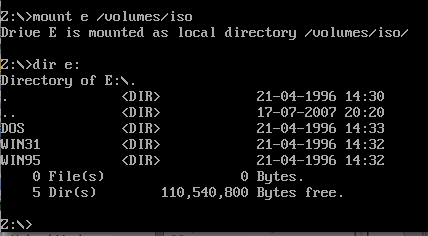

mkdir /Volumes/ISO
At this point, DOSBox is able to mount this volume called "iso" when you enter the command
"mount d /volumes/iso" -t cdrom" in DOSBox.
'Dir' it and you'll see an empty drive for now.
In the Terminal.app, type in:
mount -t "cd9660" -o "nodev,nosuid,read_only" /dev/disk2s1 /Volumes/ISO
I think, we're familiar with the mount command, we're not?
disktool -r
disktool -r will refreshing Disk Arbitration, I'm not sure if required.
Finally, in the Terminal type in:
open /Volumes/ISO
This will show the ISO partition of the CD to the MacOS Finder application, I'm not sure if it is required to be recognized by DOSBox.
From here DOSBox should be able to handle it.
Now, in DOSBox, if you type in
you'll see the PC content of a Hybrid PC/Mac CD ROM in DOSBox.
    11.48 KiB
    1261 views
    entering the command lines...
    9.54 KiB
    1261 views
    This is the PC content of the Hybric CD "SimCity 2000 CD Collection", viewed in DOSBox. I never seen those parts on MacOS X before...

Reply 6 of 18, by MiniMax
Rank Moderator
Moderator
You mistyped the nosuid (no set-user-id) option as 'nosuit' 😀 Since you didn't get an error message, I guess the mount_cd9660 utility simply ignored the unknown option, in which case I think you can omit it all together.

Reply 8 of 18, by IIGS_User
You're right, the pict shows a wrong command.
It just expected nosuid, but ignored the unknown cmd 'nosuit', eh? 😉
I've another question, since there are no differences (= no err msgs) between "read_only" as stated above and "read-only" as stated in the Terminal mount list.
Should I enter
or
mount -t "cd9660" -o "nodev,nosuid,read-only" /dev/disk2s1 /Volumes/ISO
