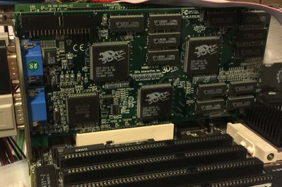

Had some DARN good luck at the recycle center today. Voodoo 2 "3.0" (110MHz RAM?) and a Creative Labs Riva TNT2 Ultra (not pictured).
Sweet.... Congrats. 😀

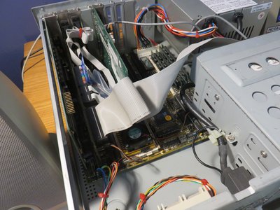

That looks like my board. Here's a picture from last year showing my power pins -- if it's the same. I'll double check when I get back to see if it's the same all around. I need to open my case. I'm not sure I ever found a manual for it, but I've found drawings showing the mobo-layout( jumper settings, etc. ).
