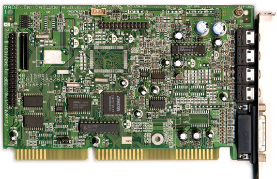

Past month I was searching for the ISA card that had it all. And eventually I thought I found it:
Codec:
Crystal CS4232-KQ
Up to 16-bit 48KHz, full-duplex, hardware compression.
Compatible with Soundblaster, SB Pro Stereo, WSS 2.0.
Potentially excellent SNR and good compatibility.
Latest Windows 9X generic driver update: 1998.
Plug and play.
FM-Music:
Yamaha YMF262-M
Compatible with SB Pro, Adlib.
Midi-Music:
Crystal MPU-401 (UART), for use with external Midi Daughterboard on waveblaster connector or Sound-Module on gameport.
Edit:
Note on windows installation, to get the card working properly I think it needs to be set to flexible PNP mode, so you need cwdinit.exe or cs4232c.exe loaded with the '/w' or the '/a' parameter in your config.sys or autoexec.bat. '/a' differs from '/w' in that it also supports SBPro emulation.
In windows 2000/XP you normally cannot load the dos initializer prior to windows startup, this will leave you with a non-functional MPU...
    78.33 KiB
    22862 views
    Soundcard: Acer Magic S23

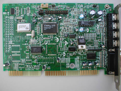

I have already installed the s23 on a 'Via apollo pro 133' based PC with one ISA slot. That PC never fancied me, but now I think the chipset is quite interesting. It only had windows 2000 and dos 7.10 installed. The soundcard works quite well in pure dos so far (Tie-fighter CD / System Shock CD / Psycho pinball). In windows 2000 it installed within seconds using Pre-installed Microsoft drivers 'crystal WDM xxx'. The opl-3 is available as a midi device, yet the mpu-401 is not. I need to look into that...
The circuit board layout of the card suggests that it can be used for an alternate chipset. that would be the s32 with the Creative Soundblaster Vibra 16S, similar to the ct2800. see image. Still some slots remain empty on either board.

    Soundcard: Acer Magic S32

Well I am not so sure for the Crystals 4232 WSS support.
On the more professional cards like EWS64 or Maxisound 64 there is a CS4236 and I also tried a rather cheap ISA card with CS4232. With all I had problems getting WSS running in DOS. While the cards hardware compatibility says it is WSS compatible it mostly locks up in DOS (or doesn't give any signal). Despite of the somewhat problematic WSS support the Crystal seems to be a decent all in one codec for SB Pro and stuff.
I think at its time it was even one of the chips with the highest SNR ratio.

I haven't tested the WSS functionality enough myself judge that. Do note that there is a cs32wss.exe utility to switch it to WSS mode once it has stuck to SB-Pro mode.
Also I think there are actual miles-sound drivers for this chipset: digmaxi.dig and mdimaxi.mdi. So you by installing these manually in a game you can also use it in another way then SB-Pro. Though I am not sure it really matters much, because most games have 8-bit sound.

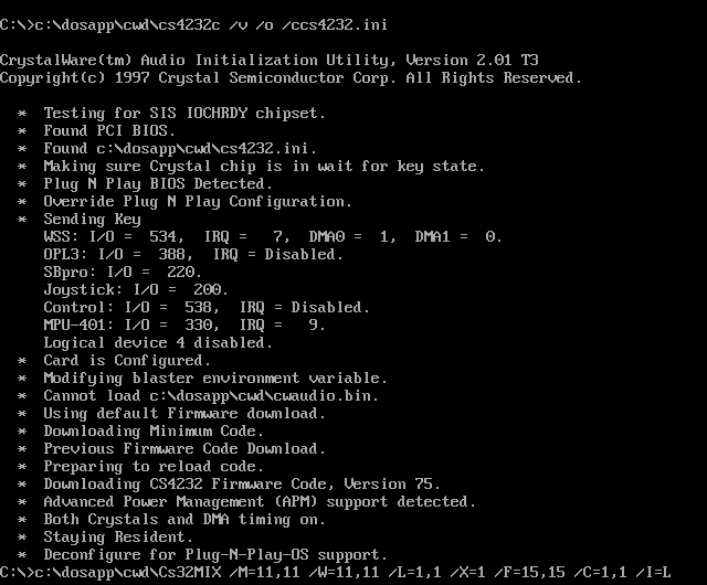

Last but not least a screenshot I made of the generic CS4232 DOS setup. The cwaudio.bin line is no error, it is an optional thing. I don't know if the initializer is required as a TSR and how much memory it uses. It never gave me any problems with games as such.

    CS4232 Dos Setup Verbose Mode
