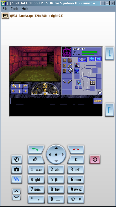

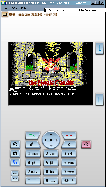

hi all,
with the help of some gurus on the forum, i've finally gotten my s60 (wincw emu for now) build to run - which has been done before -, and also to run a dos game (magic candle) - which i'm not so sure has been done.
anyway, if all goes well, there will be some updates and hopefully a sisx release soon...
here's a shot :-)
cheers!
ps: eye of the beholder actually plays! i had to do some key mapping so that i can make the setup choices, but after that the sdl virtual mouse pointer worked (almost) like a charm :-)
ps2: an emulator running in an emulator... creepy :-)

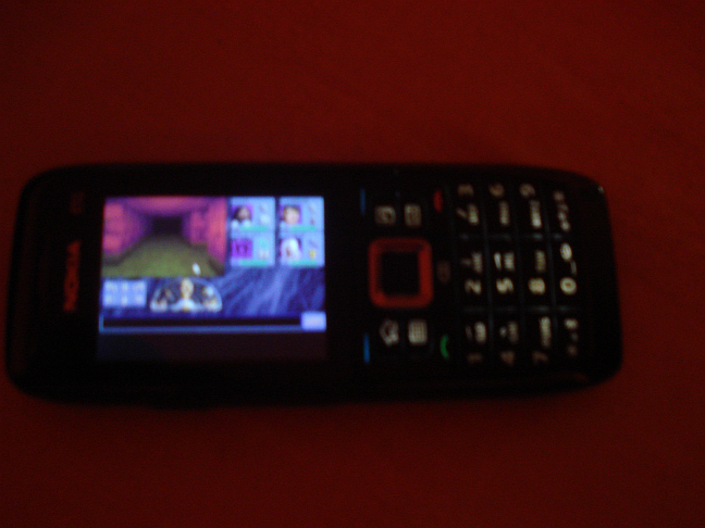

haha!
the good news: its finally working :-)
the bad news: its pretty slow (haven't tinkered with any settings yet)...
check out the photo (its blurred. i have yet to figure out how to photograph my phone's screen)

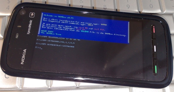

Reply 18 of 197, by fernando20
Good news, it works on S60 fifth edition! No keyboard means I can't do anything with it, but it's already awesome, will try on my N95 later.
edit: no dice on my N95-1, dies with a not enough memory error on boot. So you'd need more then 30mb free ram it seems.
