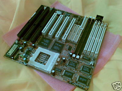

I bought a PC Chips mobo, with the infamous VX chipset. 😖
Luckily, it didn't cost much. I didn't realise it was one of these laughed at mobos, until it arrived. The box said "PC Chips", and it was only then that I realised it might be one of these things.
Oh well. I guess I could use it for some, um, "experiments". 😉
(Photo is seller's pic.)

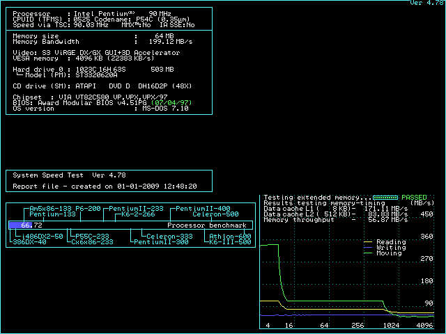

I've just tested this PC-Chips VXPro+ chipset based mobo, as shown in the post directly above. The results of this test are shown below. Are they bad? (I haven't worked out what all the numbers mean in these speedsys tests yet.)

Reply 16 of 17, by elianda
here are some comparison values: http://www.dosforum.de/viewtopic.php?t=2341
Youtube Channel
Reply 17 of 17, by retro games 100
Thanks! Hehe, there are some familiar faces on that board I see! 😀 Quite a few of those tests have been done with an Intel Pentium 166 MMX. I might have to dig one of those out, and retest the PC-Chips mobo with this CPU, so that I can compare the results with the results on the dosforum website.
