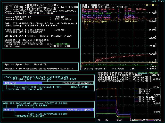

@Malik, I have now been able to do a speedsys test on this board, using an Athlon 1000 CPU. Ram used was 1 stick of PC-100 SDRAM. Graphics card used was a lowly 8mb AGP Rage card. Incidentally, I ran pcpbench and it gave me a score of 56.0 I haven't run fastvid, or anything like that yet.
    82.48 KiB
    2531 views
