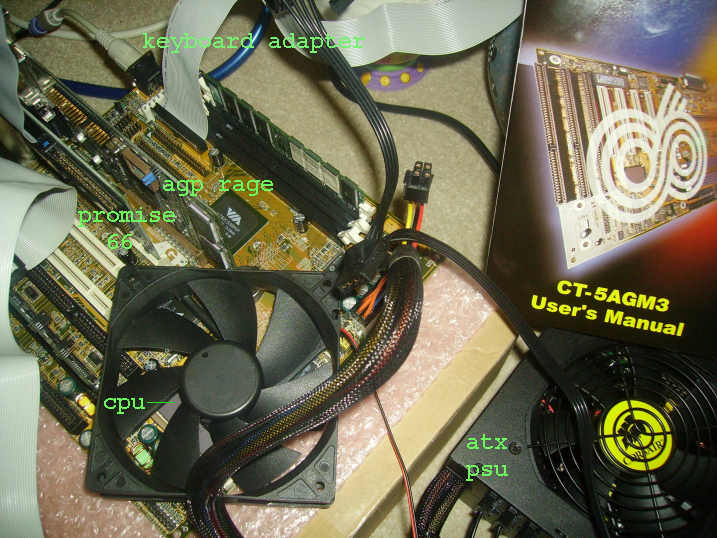

Reply 13 of 33, by retro games 100
Can I join in with some general P166 MMX discussion please?
I threw together these bits n pieces below, and installed win95c on it. All seemed well. Then I installed the Via Apollo "4 in 1" chipset package, which destroyed everything. Maybe it was "pilot error", who knows? I wiped the HDD and put win98 on it. All seemed well again. And this time, the Via driver package installed without wrecking everything.
Speedsys gives me a score of 126.27 for this P166 MMX powered Chaintech rig.
@Malik: I must get around to testing the MSI 5169 mobo!
    84.74 KiB
    3450 views
Reply 15 of 33, by retro games 100
h-a-l-9000 wrote:
What do you expect of VIA?
I'm not sure, as I haven't had much experience with their mobos. Are they known to be problematic? (I'm guessing that your answer is going to "yes..")
Reply 17 of 33, by retro games 100
swaaye wrote:
Super 7 mobos suck and most of the suckage emanates from the AGP slot. That's about all that needs to be said.
Are there any specific games/tests that I can run, to see this "suckage" for myself? I tried a small handful, the usual suspects like Doom, Quake, Hexen, 3D Realms' titles, bla bla, and they seemed ok to me. The mobo's BIOS has a "2x AGP" option which I enabled, and the VIA chipset driver had an "AGP turbo mode", whatever that means, which appeared to install OK.
I dunno, it seems alright to me, but then again, I need to try out a few difficult to run games to see how it copes with them...
Reply 18 of 33, by swaaye
The AGP port is going to be unstable with most AGP cards. Voodoo cards will work fine though as they are basically PCI cards. The instability usually shows up as random freezes or crashing in 3d games. It might happen in 5 mins or after an hour. Hell, some cards will refuse to do D3D at all. It's both power related and buggy AGP implementation related.
Don't enable AGP 2x or anything called Turbo mode in the BIOS. That will probably exacerbate the flakyness.
The problems are mobo, video card and chipset related. Poorly programmed BIOSs and low quality mobos combined with a first generation AGP implementation. Video cards that started to pull too much power from the AGP slot on boards that never imagined a GPU like a GeForce 2...
What video card are you using?
