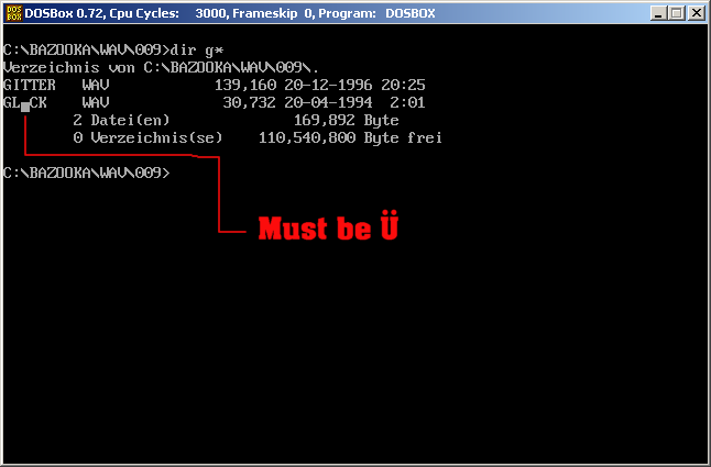

I wanted to play an old DOS game with DosBox.
It's name is "Bazooka Sue", a german point&click adventure.
Now I got some trouble reading WAV files.
The game tries to load WAV files like "GLÜCK.WAV" and other files containing letters Ü,Ö,Ä etc...
What can I do to fix this?
Please have a look @ the attached image.

you are out of luck. dosbox will not load files with these characters.
You can view them in dosbox though by setting the correct keyboardlayouy/codepage

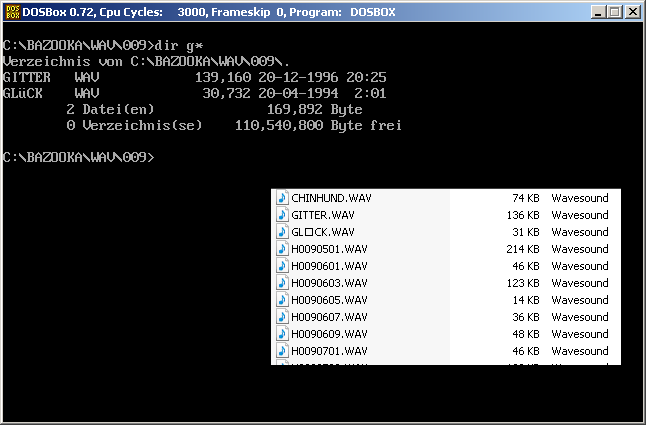

I managed to make the chars visible, but DosBox still cannot load them 🙁
Will there be a fix in future releases?

I'm not sure why the devs are opposed to including support for diacriticals in filenames
Because "just passing strange characters" through doesn't work, you need
translation tables from OS codepages to dos codepages. Look at the explorer
screenshot he posted above where the dosbox screenshot has an umlaut.
In the reverse, when in the explorer there's an umlaut your it's-so-easy
passthrough idea would result in surely no umlaut in dosbox.

historically the limited amount of allowed characters is a safegaurd against trying to open files when the memory gets corrupt.
In that light exceptions were added for games that needed them. However correct support would be more tricky.
