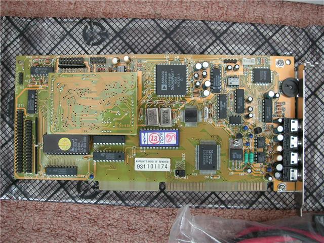

Correction - it's a Midia Sound 2000 SB card. Photo below. Anyone heard of these things?

Are you sure the brand is Analog Devices? I think maybe they just made the DAC chip because I can't find any mention of sound cards on their web site.

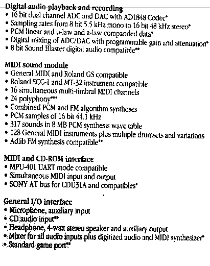

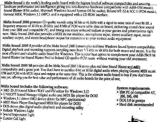

I think perhaps the company is called Midia? I have managed to obtain the blurb on the back of the box...

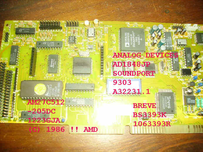

'Magic Midia' from Germany made some soundcards. Yours obviously has an AD1848 codec and also a 'Breve'? ISA interface chip. The AD1848 usually means WSS compatibility, any other compatibility must be handled by the Breve chip. I read SoundBlaster is mentioned, but SoundBlaster Pro stereo is not? I wonder what takes care of the FM, maybe there is a genuine OPL3 hidden beneath the DB. The DB is said to be 8MB, which is suprisingly big. I am curious as to what chipset the wavetable has.

Google 'AD1848 breve' or something. The breve chip is the main interface, the important chip. here is something: something [Edit : Nevermind this link, it does not contain what it should. Looking further I must say; this is a though one, hardly any references on the internet...]
Concerning the wavetable: On second thought I suspect they mean 8 MegaBit, thus 1 MegaByte.

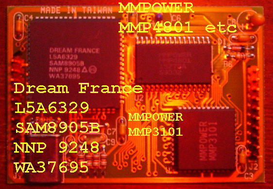

Maybe you can make another picture so I can see the other chips?

Regarding the onboard wavetable capacity, it's interesting to note that the box's blurb says -
PCM samples of 16 bit 44.1 kHs
317 sounds in 8 MB PCM synthesis wave table
128 General MIDI instruments plus multiple drumsets and variations
I think that sounds "badass" enough to be more than 1 meg.
Regarding further photos of the board, please see below. The 2nd close-up photo is the underside of the daughterboard attachment.
