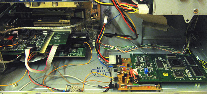

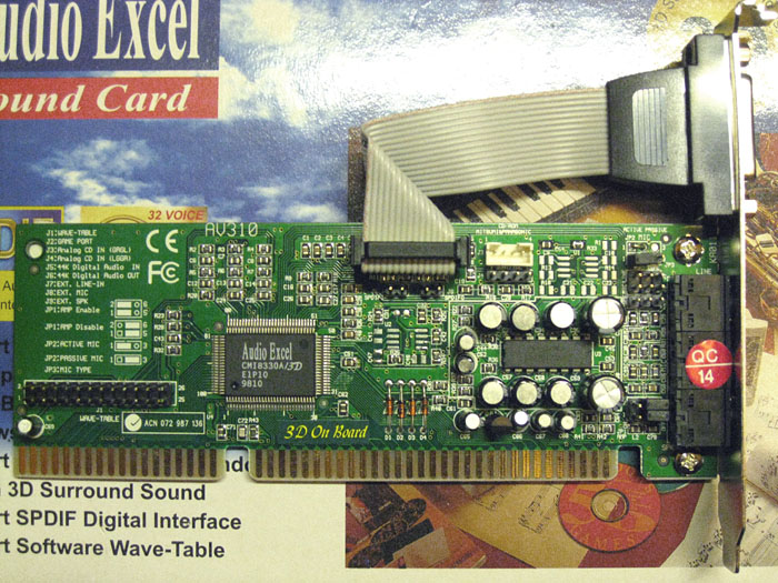

Postby gerwin » 2009-7-10 @ 21:29
Wanted to write a small review on this card, but it seems to have gotten quite extensive, enjoy :).

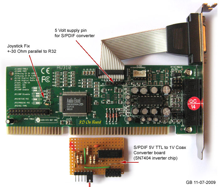

Soundcard: Audio Excel CMI8330 (PCB-ID: AV310).
Origin: China/Taiwan around 1997.
Chipset: C-Media CMI8330/A.
Soundcard also sold as: Zoltrix Audio Plus 6400 3D PnP V.5.
Chipset also available on: Soundpro onboard audio ; Artisto Soundpro ; Soundpro HT1869V+.
HARDWARE
It is a compact single chip ISA card. There is not even an oscillator, which is a bit questionable. It has a Gameport, Line out, Line in and a MIC in. There are also small connectors behind each jackplug socket. This is AFAIK the only card with this chipset with a waveblaster header. The gameport connector would obstruct a midi daughterboard somewhat. The card has an amplifier which can be disabled with jumpers, as it should. There are jumper-like connectors for S/PDIF in and out (44KHz). These are 5V TTL level, and need some form of simple converter to make them suitable for a 1V coax connection.

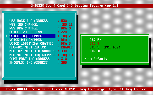

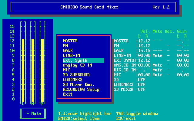

PURE DOS
The DOS software is nice. You can load the PnP initializer and the mixer with a menu or with parameters. These programs are exitted when done (no TSR's). Next to that there are some extra tools that are a nice bonus, such as a wav player and a recording tool. SB/SBPro/SB16 compatibility is quite good, but not flawless. WSS compatibility has worked in all the software that supported WSS, but only when the DMA was set to 0. Adlib/OPL-3 is done in hardware, and sounds much like a genuine OPL-3. MPU-401 for external midi worked perfectly with a midi daughterboard attached to the card. The Signal to Noise ratio sounds fine, but I don't know how to measure it. I expect S/PDIF to output by default even in pure Dos.
The gameport behaved a bit odd, as it would only allow the joystick to be used for windows applications. I found that an Microsoft Gamepad FAQ listed this Soundcard as not giving enough current or voltage due to a certain resistor. I found this to be resistor R32 near the waveblaster header: IIRC it was 47 Ohm, and I put a 30 Ohm resistor parallel, practically lowering it to 18 Ohm. After that my joystick worked fine!

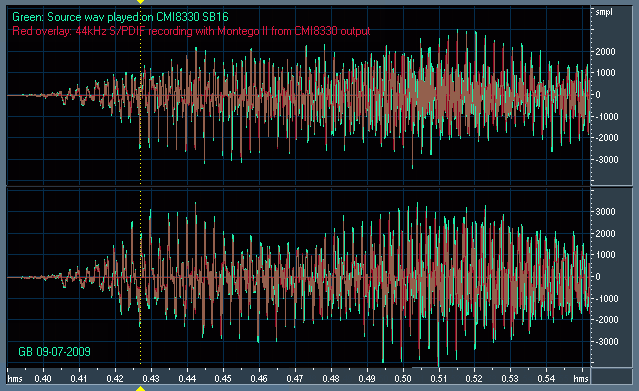

I connected the CMI8330 S/PDIF output to the Vortex-2 S/PDIF input using a self made 5V to 1V converter and the official Vortex-2 I/O bracket. That works very well, the ISA card is completely silent when not in use (because of the mixer settings), and outputs a flawless digital signal to the PCI card when used for SB16 emulation in a Windows Dos box.
SUMMARY

CON's (some are futile or fixable)
- Joystick resistor issue.
- The gameport connector would obstruct a midi daughterboard somewhat.
- Requires a converter for 1V coax S/PDIF.
- No oscillators, so ISA clock dependant (I have seen an oscillator modification on the net).
- Not 100% SB compatible, more like 95%.
- Doubtful DAC quality.
- OPL-3 is not genuine Yamaha.
- Poor English grammar in the Documentation.
DOS Initializer CMINIT.EXE
Dos Mixer CMMIX.COM
S/PDIF comparison

valnar wrote: 1) Do you have pictures or instructions for the joystick mod?
The way I wrote it should make it quite easy already. the original SMD resistor designated 'R32' is a bridge between two contacts, and one has to solder the other resistor as an additional bridge besides/over it. See photo.

I prefer to use every ISA soundcard next to a Vortex-2 soundcard when possible. The vortex-2 has a quality 18-bit DAC. Most ISA cards have an inferior DAC or lag a bit when using Directsound accelerated games.
It is especially nice when I can make a S/PDIF connection to the vortex-2 S/PDIF 'breakout bracket' that I have. Attached a photograph of my setup, which probably raises more questions then it answers ;). If only the vortex-2 S/PDIF input was working in pure dos :sly: ...

Edit: The one thing I don't see is a way to enable the wavetable board in the midi mapper in Windows 3.1. It defaults to a FM mapping with no other option.

Quick question here, gerwin--or anyone using the ISA CMI8330: can the FM/OPL3 be disabled or not initialized (so as not to conflict with another card at 388h)? Thanks!

Postby bestemor » 2009-7-14 @ 20:34
@gerwin:
heh :blush:
...could you narrate that bottom pic a little ?
(as I'm having some trouble figuring out whats in there)
You don't have to explain the setup or anything, only describe/name the item itself.
Bottom left seems to be the Cmedia isa card, on top of that is a Turtle beach Vortex 8820 (A3D?)... so far so good.
...but then I'm slightly confused with whatever is covering the TB card.
(looks like a soundcard, but not occupying any slots?)
I'm guessing that is the "official Vortex-2 I/O bracket" ?
Didn't know these budget cards even HAD such a thing (!)
And then theres that small 'thing' above that again, what looks like a 'usb' cable? from a pci slot or whatnot :confused:
I assume the bottom right is a Korg daugthercard, or ?
(on some weird converter contraption?)
Just curious.... :happyhappy:

Postby gerwin » 2009-7-15 @ 09:35
valnar wrote:I received my CMI8330 ISA board a couple days ago and installed it in a DOS/Win3.1 Pentium 166. So far, I love it. It works great at everything I've thrown at it and has a high compatibility mark for me. The only thing I don't like is the (lack of) support for holding the wavetable board. And mounting a WT board also hits the gameport ribbon. Other than that, I have a new favorite DOS sound card.
Good to hear it from someone else! Have you tried a joystick with or without the fix yet and which wavetable are you using with it?
archsan wrote:Quick question here, gerwin--or anyone using the ISA CMI8330: can the FM/OPL3 be disabled or not initialized (so as not to conflict with another card at 388h)? Thanks!
Not really, but you can put the soundblaster and adlib I/O to hex 240 and 398 instead of the default 220 and 388. Wasn't the soundblaster base address also an interface to the OPL3?
bestemor wrote: ...could you narrate that bottom pic a little ?
You got most of it right already!
you are looking at:
-a Soyo SY-6BA+III Mainboard (i440BX).
-PCI USB 2 adapter, with the internal fourth port cabled to the outside.
-Montego II Home Studio S/PDIF bracket (cabled to the Montego II, insulated with a piece of paper between them).
-PCI Turtle Beach Montego II soundcard (Vortex-2 AU8830)
-ISA CMI8330 soundcard with joystick fix and S/PDIF voltage adapter, connected to Montego II with both a S/PDIF wire and an analog jackplug wire.
-Waveblaster daughterboard home-made adapter, using PSU power.
-Topwave Korg Waveblaster daughterboard 4MB GM (with attached jackplug socket), midi input routed to both the CMI8330 and Montego II, analog output routed to Montego II.
-A small adapter cable (red/black) to route the mainboard's PC-Speaker signal to the Montego II Aux-in.
Here is another view of the Montego II package: Vogons: Vortex2 card under Win XP
Good to know--and no, AFAIK FM Synthesizer address on soundblasters (and maybe most cards with real OPL2/3 chip) is usually fixed at 388h, just like on the original AdLib card. I guess that's to maintain perfect compatibility with original AdLib-supporting games (with no option to change address). With this CMI8830, seems like one can pair it with a real-OPL2/3-equipped card to enjoy the "truer" AdLib/FM.
