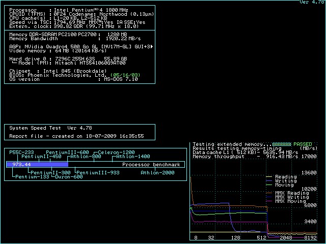

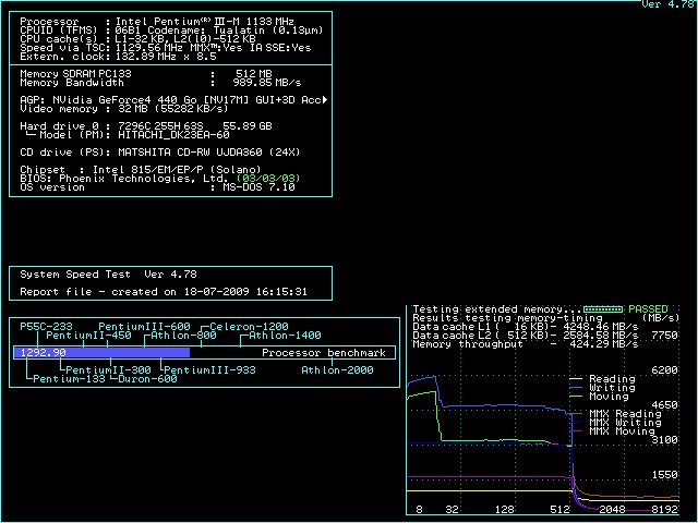

I dug two laptops out of my pile of old stuff the other day. One is a Dell Latitude C810 with a 1.13 GHZ Pentium 3 Tualatin processor. The other is a Dell Precision M50 with a 1.8 GHZ Pentium 4 processor.
I was bored and ran SPEEDSYS with a bootdisk on both machines. I expected the P4 to win because of the clock rate advantage. Much to my surprise the P3 chip won by a large margin on the CPU score.
The P4 is a northwood processor with a 400MHZ bus. Its memory bandwith kills the P3 because of DDR vs PC133. I know that clock for clock the the P4 is an inferior processor compared to the P3, but these results suprised me. I am uploading the test results; anybody have any ideas as to why the P4 lost badly?

Have you tried to disable HT in the BIOS for the Northwood? Maybe that would help lessen the performance loss for this app.
The cache result for the P4 seems strange to me: L1 at 512K, no L2 cache, writing drops before 128k...
Also, though effectively runs at 400MHz QDR, that P4 is actually a 100MHz bus processor, more like the first-gen P4 than its desktop counterpart (200MHz/800MHz effective).
I don't think a 1.8 Northwood has HT, nor does the 845 chipset support it AFAIK.
In any case, there's something wrong with the benchmark, that's for sure... the P4 is slow, but not that slow. The 1.13 P3 should be roughly on equal footing with a 1.8 P4, and will fall a little behind on certain multimedia tests that take advantage of some of the optimizations in the P4.
😦 righty there, i don't remember the P4 lineage that well. The lowest clock HT P4 was the famous 3+GHz budget rocker 2.4C which was also--to me--the only P4 worth buying.
I thought one of the biggest performance loss of the OP's P4 came from that strange cache result (and i assumed too quickly that the caching problem is caused by HT's shared multithreading). Compare that to the P3 cache result chart, which corresponds well to its 32K/512K configuration.

P4's L2 cache is silly fast so some apps might think it's the L1. Also the P4's L1 data cache is an itsy bitsy 8KB. The other 12KB is the L1 trace cache. I'm sure they had to keep the L1 caches small because of their desire for high clock speed instead of purely performance per clock.
You can't really complain about the performance of Intel's cache's starting with Coppermine....
Another thing to remember is that P4 has terrible x87 FPU performance. This test might be measuring that aspect of the CPU.

This is not so suprising since P3 was used as the baseline for Core 2 technology and P4 was dumped entirely.
While it's true that the Netburst architecture was a giant flaming ball of poo, (and yes, it was dumped in favor of a rework of the old P6 architecture), the fact remains that a P4 shouldn't be that slow.
Here's a link showing some other guy's System Speed Test results with a Celeron 1.7. That chip should be significantly slower than a 1.8 P4, but it's turning in better numbers than OP's. Notice the CPU speed index of 1145, versus the 973 OP has, and also look at the huge gap in memory bandwidth numbers. There's something wrong here.
I did notice, when searching for suitably similar speed test results, though, that the cache seems to be misreported on other P4-based chips as well. I'd guess it's probably just a quirk about the way the program sees it, and maybe swaaye's analysis is correct as to why.

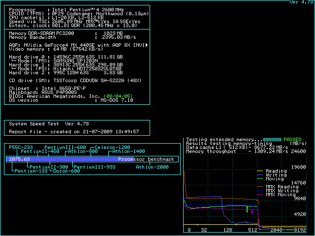

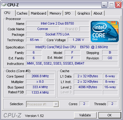

Here is another Northwood Pentium 4, the one at work. I brought a bootdisk today so I could benchmark it. It scores quite a bit more then 2mourty's 1800 MHz Pentium 4. But still less then the AMD-3000+ systems at home (2416,26 points).
Edit,
While I am at it: I also ran these diagnostics on another Pentium 4 and on a Core 2 Duo system.

Btw, the Core 2 result seems to challenge the previous assumption on the P4 cache (about the L2 cache being so fast it is recognized as L1), as the three levels of caches are all recognized properly.

Except for the fact that Core2 chips don't have L3 cache. I'd say it's less to do with the speed of the cache or anything, but is just a case that the program uses a certain limited set of parameters for determining the cache size and layout, which doesn't work properly on newer chips.

I gathered that he was talking about the System Speed Test results, since that's been the subject of the rest of the thread. Speed Test shows three levels of cache... L1, L2, L3. Core2 chips don't have L3, nor does that chip have 6MB of cache in any configuration.
CPU-Z correctly identifies the two levels of cache: L1 32KB+32KB, and L2 4MB.

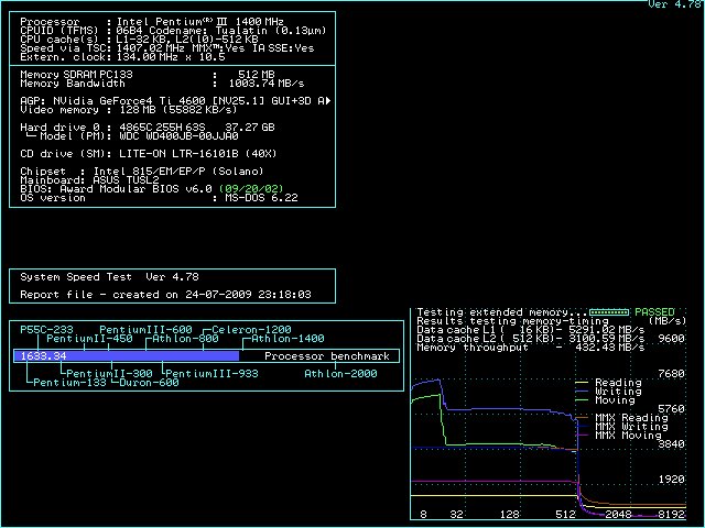

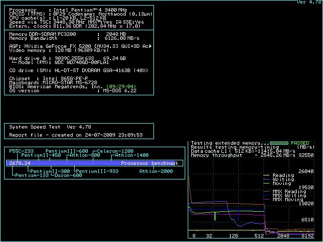

This is a fairly surprising result. Although the Tualatin core P-III's used an arguably superior architecture than the NetBurst P-4, the brute force speed difference in FSB and memory (PC-133 vs. DDR-400) should have edged out the Tualatin.
It's possible that the bios settings in each might have skewed the results. Nonetheless, it goes to show the legs that the i815 B Stepping chipset plus Tualatin CPU's had.
I still have a 1.4Ghz PIII-S, and it's plenty fast and responsive (and a great DirectX 7 and 8 rig, to boot!)
I've posted my PIII-S Tualatin 1.4 and P4C Northwood 3.4 for comparison.
