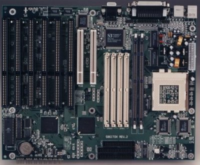

I have the chance to acquire a set of this motherboard complete with P233MMX and memory plus several units to stock as spare parts.
DFI G586ITOX quick spec:
Socket 7
Intel® 82430TX PCIset
ATX
S3 Trio64V+ 1MB integrated
1 dedicated PCI slot
5 dedicated 16-bit ISA slots
1 shared PCI/ISA slot
complete specification on DFI website
Do you have an experience with this motherboard? What's your opinion of it? I will be using this model to build a retro system with lots of sound cards (configuration details aside--i know it's going to be tricky 😉), but maybe i will have to avoid sound cards requiring 5V to use with this 430TX mobo (might only work with 3.3V ISA--confirmation needed).
Thank you!
Added pic of the gorgeous mobo:

Hey..I got one of these too a year ago but haven't tested it yet...I love the idea of having all those ISA slots 😀
Mine came without the I/O shield 🙁

I have very good experiences with DFI boards. Particularly those with ISA slots. Unfortunately I have never used this one.

Well, i don't know which model exactly you referred to, and i haven't checked any of DFI P4/ISA model either, but up until ICH4/5 southbridge, there should be DMA support for ISA which is required for DOS sound. While the Intel Express chipset family (ICH6 and afterwards) have limitations on this matter. I remember reading a forum thread where a member decided to buy an expensive COMMEL P4LA industrial mobo (supports Core 2 Duo IIRC) with ISA slots, then reported back that there was no sound in DOS...
On the other hand, the ICH4 on this interesting Pentium-M mobo with ISA supports DMA via LPC (which is "similar to ISA DMA", the manual says). PC/PCI DMA is also present. If this proved to work well with ISA soundcards on DOS, this could almost be a winner for late DOS games/Win9x combo (Pentium M 2GHz!). "Almost", because the AGP slot is "cut out" 🙁 Wondering if there's a similar mobo with an AGP slot (maybe with 855PM northbridge instead of the integrated 855GME)...
_____
Back to topic--because so far i've got no bad feedback on DFI mobos in general (i know finding someone who uses the 586ITOX on a daily basis--today--might be difficult), i decide to order a couple. Depending on communication and actual shipping, it might take longer before i can report back--besides, i have not yet collected that many classic ISA soundcards 😀
